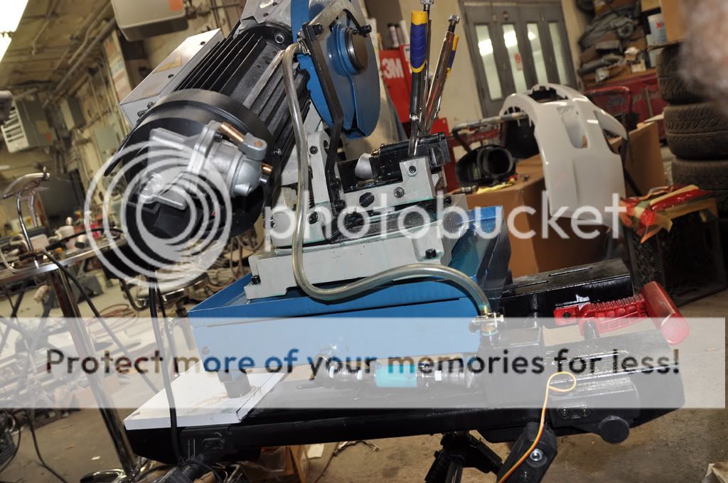

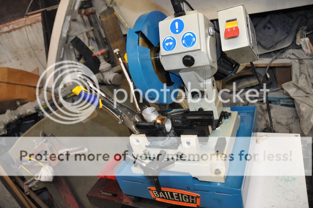

ok, I'm doing a bit of fabrication work and cutting on 1 1/4" schedule 10 stainless steel pipe & 90 deg. weld el's for a set of headers I'm building. at first I was doing this whole job with an abrasive chop saw & then grinding the edges to a finished edge. this was a long & tedious process not to mention a bit dangerous as trying to get precise cuts at angles on little 1 1/4" weld els with a chop saw is far from ideal. many jamb ups, blades breaking, hunks of SS flying through the shop, in the end I decided that I just had to find a better waywell I decided to look into what might be a better way to do this, my choices boiled down to either a carbide dry saw, a band saw or a cold saw. after considering each methods benefits & drawbacks I decided that a cold saw would be my best option for the best overall cut.well I ordered a baileigh 9" cold saw because I wasn't looking to spend close to 2k or more for a really good saw for just this project & it seemed to be the most economical way of getting into a cold saw. I received the cold saw & set it up & from day one the fluid pump just did not work at all.what baileigh uses as a fluid pump is a mechanical pump driven right off the rear of the motor shaft, the pump they use is actually a fiat fuel pump, & the problem with it was internal corrosion. this pump is a diaphragm pump & uses a tiny internal check valve, when I opened it up the tiny check valve just pretty much disinigrated in my hand,baileigh's answer to me about this was that they are having this problem occur as the saws are shipped over by boat from china & the time at sea was causing this corrosion. they did not even have another good pump to send me as it seems this problem is affecting all of there pumps... so I decided to just make due & try to rig up my own fluid pump.at first I did this with a smaller 12v fluid pump, I used a pump that was designed for a liquid PC cooing setup.. it did kind of work in the beginning but after a while it just died, another part of my problem is filtering the chips, I didn't want the chips to flow through the pump as I can't see that being good in any way, but the small fuel filter I used at first would fill up & clog with just one cut.anyway, I finally winded up buying a much larger pump from a marina, it uses a flexible impeller so even if some particles did happen to make there way to the pump it would not really affect it.I also winded up using a home water filter setup as a filtration device & as the actual fluid tank instead of the chip try that baileigh uses in the base of the saw...here are a few pictures of this setup & so far it has been working well for me, but I was wondering if anyone else happens to have a cold saw, how does your cold saw handle the fluid pumping & chip filtering? I've googled & searched around but haven't found much info about this & figured some here may have some experience with stuff like this, I'm curious as to how other manufacturers handle this & how reliable it has been.    here is a picture of the jig I made to hold these weld el's at any angle I set it to for my angle cuts:

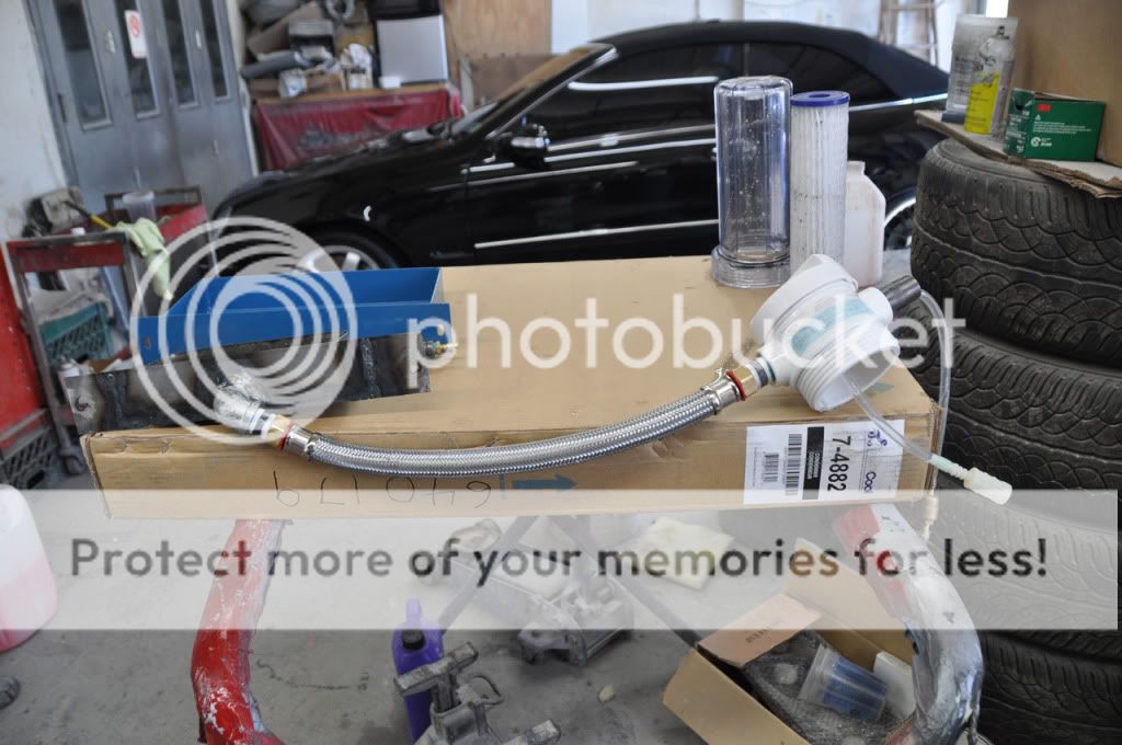

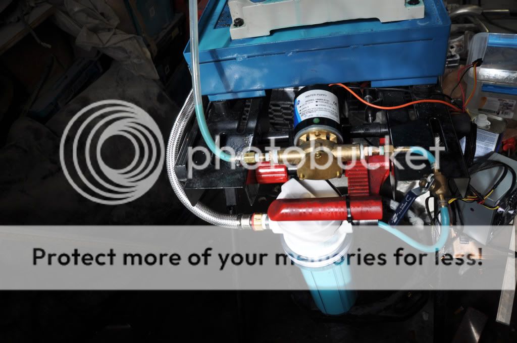

Reply:here is the fluid system that I devised at first, did the job for a little while at least:

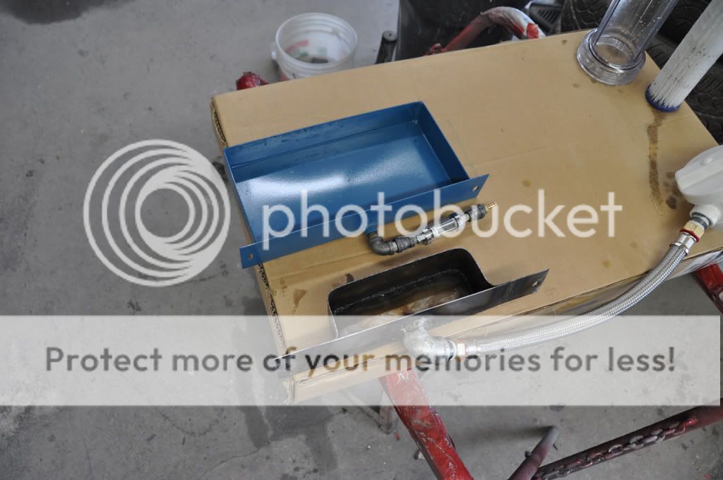

& here is the way I redid it. this picture shows the original coolant "tank" which is just a drip tray at the base of the saw. I made a new catch to replace this & it feeds my new filtered reservoir

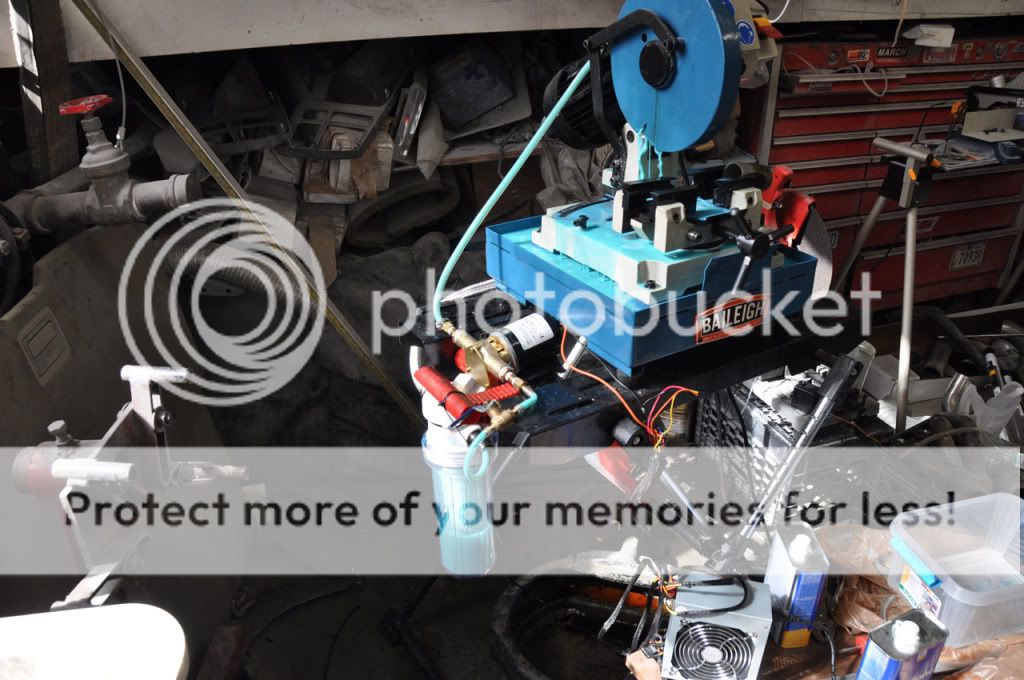

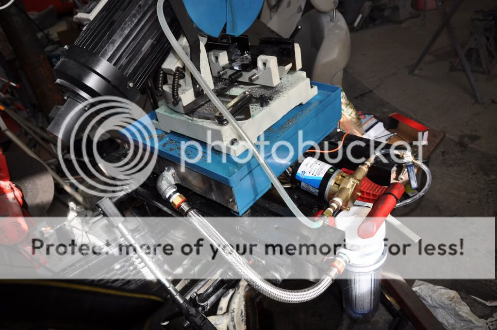

here it is assembled to the saw

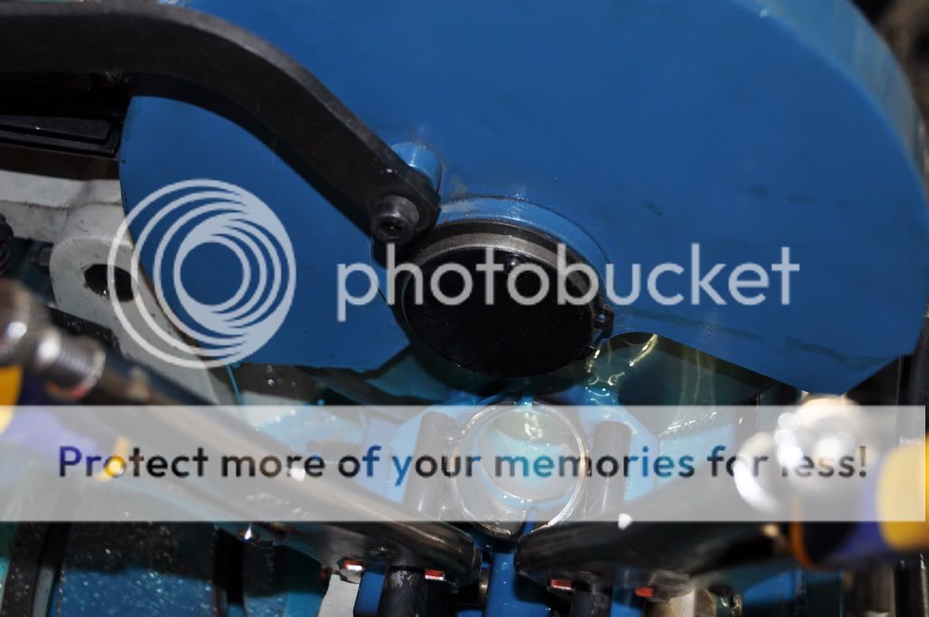

& here it is running. I'm using a valve in line to regulate the flow so it doesn't empty the reservoir to quickly, otherwise it tends to aerate the fluid & make it foamy. adjust it to just enough to keep the fluid level above the pickup level when running & it works great
