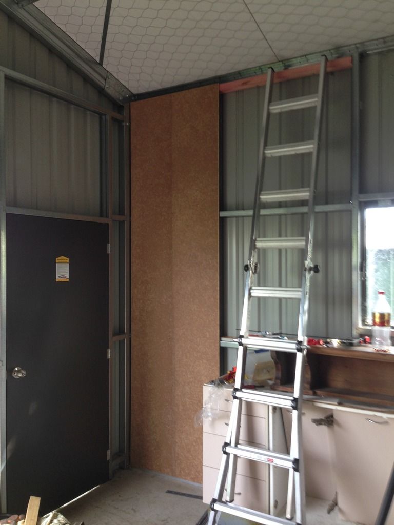

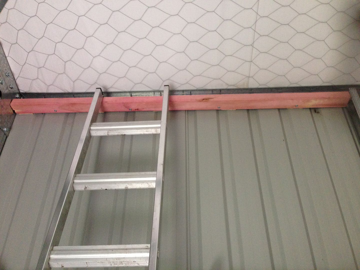

Reply:I want to line the garage all the way up, the top beam is a different size to the others so had to improvise. I need to get at least one sheet up to mount the electrical panel to. The lining I am using is stuff called triboard.

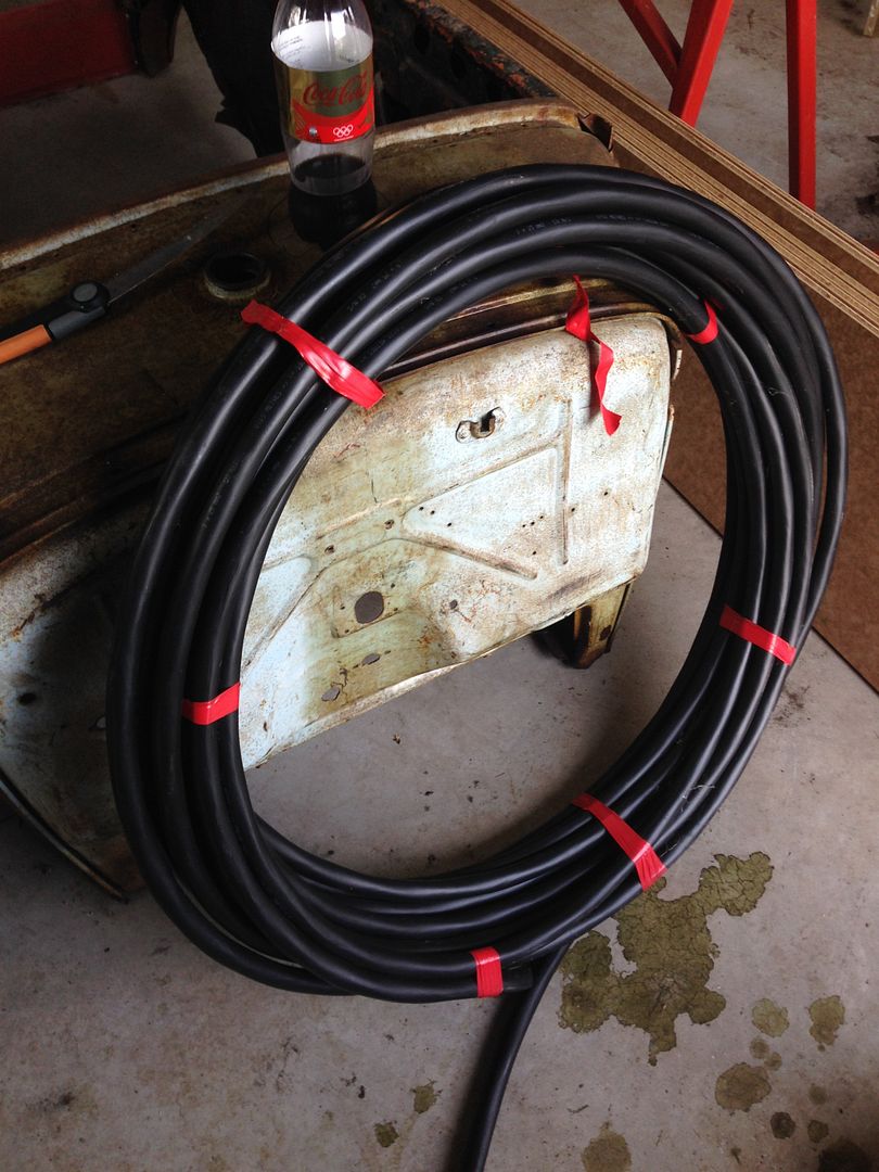

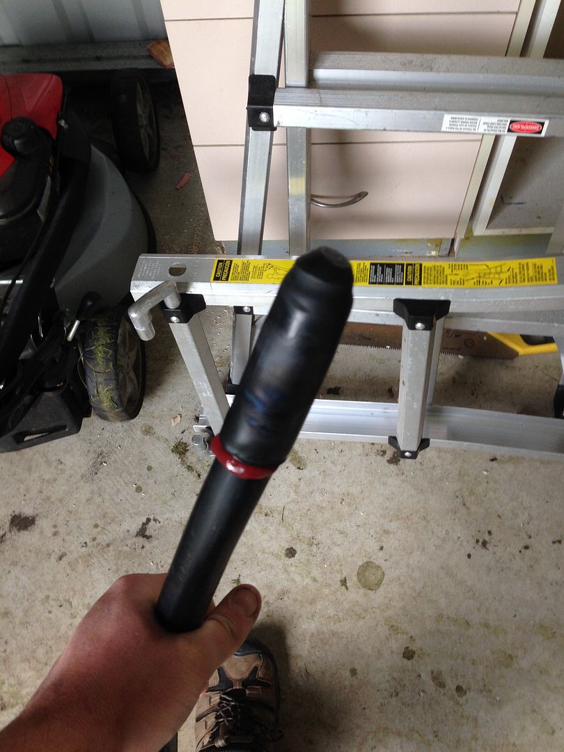

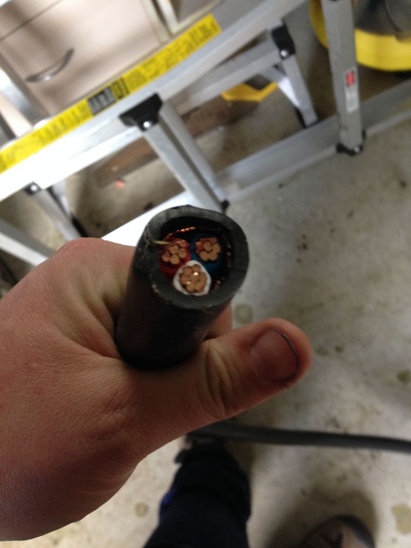

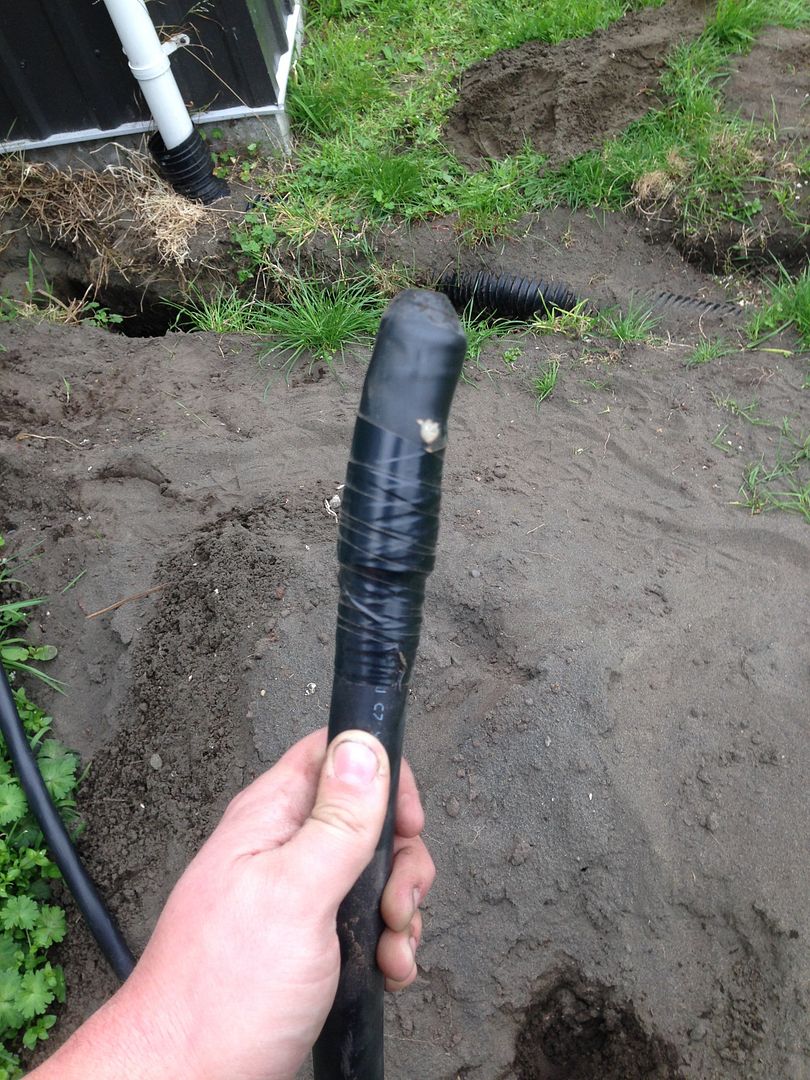

Reply:Quest continued today with running cable. From the street to the house is whats known locally as 35mm 3 core neutral screen made by General Cable. In easier terms its an underground rated 3 core copper cable used for 3 phase installations. That was installed about a year ago. From the house to the garage is 25mm 3 core neutral screen made by Olex cable. The reason for using the bigger cable from the street to the house was price. We found the required length of cable for a very good price but it was of the larger size. Which can never be a bad thing. The cable I ran today is the 25mm and is over about a 100 foot distance but can handle 153amps when buried direct and over that distance has less then 1 percent voltage drop.
I went to the local electrical store to get insulation tape as the cable will be exposed to the elements until the connections are made. When I explained what I was doing to the guy who works there he showed me these shrink fit cable covers, they are filled with glue to create a good sealed fit when shrunk. Though I do question the the thoughts of whoever invented them as while shrinking them they just got more and more phallic looking. Weird. The staff member at the store was impressed that I wanted to protect the cable in such a way as apparently a lot of people don't think about that.
Still put insulation tape on just for good measure, can never be too well protected.
Gear: Esab power compact 205 with tbi industries torch         BOC Smootharc 185dc tig         Miller Syncrowave 350LX

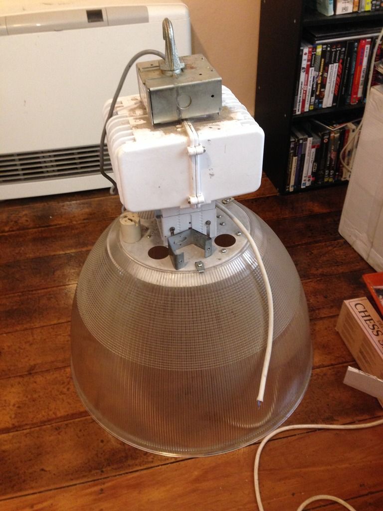

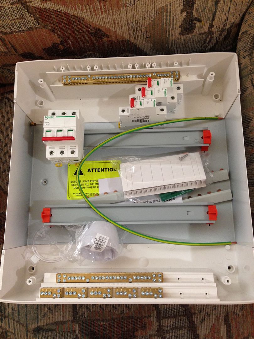

Reply:Decided to pull this out and get it a bit ready as this will be going up soon.

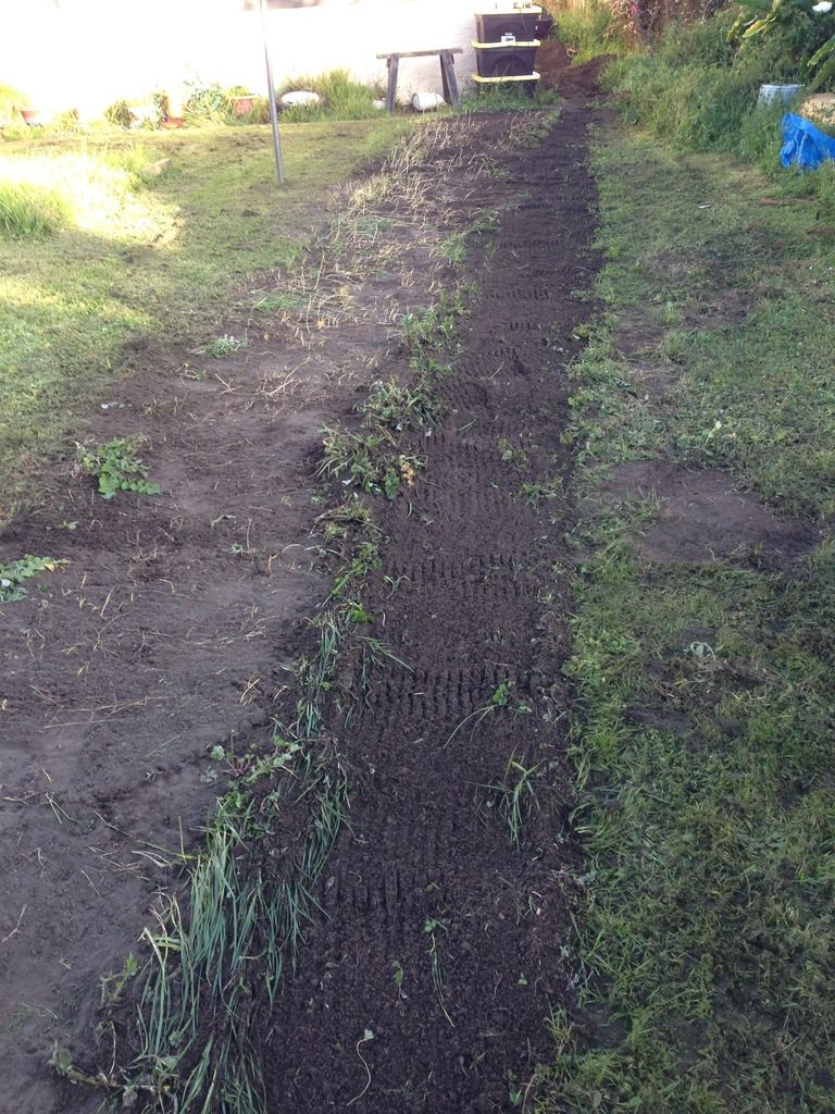

Reply:Not a big update as been feeling under the weather this weekend, but got the cat 6 in the trench as well and back filled and put down the cable warning tape, then fully back filled.I laugh when digging trenches as you seem to end up with more dirt after backfilling then what came out when digging.
Reply:A couple of wall boards up so that I can mount electrical panel. Not huge amount of progress this weekend. Had some other stuff going on.
Reply:Looks good.Y'ur getting closer!Panel boards tend to swell and sprawl... are you sure there isn't somewhere other to locate the board, rather than in the swing path of an entrance door?
Reply:That is something I had thought about but there should be enough clearance as long as it only gets wider taller and not deeper haha unfortunately behind the door is really the most convenient "out of the way" place to put it. I'll definitely have to put a door stop on the wall.Gear: Esab power compact 205 with tbi industries torch         BOC Smootharc 185dc tig         Miller Syncrowave 350LX
Reply:Getting the light ready.

Reply:Ok so update. I used to have a 351. I now have a 350lx. My 3 phase has all been installed and my Syncrowave is hard wired as that was the economical way to go. I wound up going with batten style LED lighting just because I wanted to prioritise power for the machines. LEDs do just fine without using much power.
