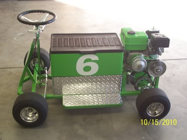

Here are a few pics of the ice chest racer that I built. It was the first major project I ever built.

Reply:Very very nice. The attention to detail is great. It is also nice that the kids were involved.So many parents do not involve their kids in things other than sports.The only thing I see that isn't "right" is your spindles are swapped left for right. (The steering arms should be at the top.) This will throw your Ackerman principle way off and you will have a heck of a push going into the turns!
I'm surprised the other eagle eyes on here didn't see it!!Oh, by the way, crops are green-tractors are red!Rex
Reply:Thanks for all the compliments. As far as the spindles I will keep that in mind. I have a free rotating hub on the rear axle that helps with the steering on the turns.

Nice job! Like the hand controls! What size its the motor?

The motor is a 6.5HP clone of a Honda.  My neighbor thought of building something similar to it but with a saddle on it and painting the frame like a spotted horse.
