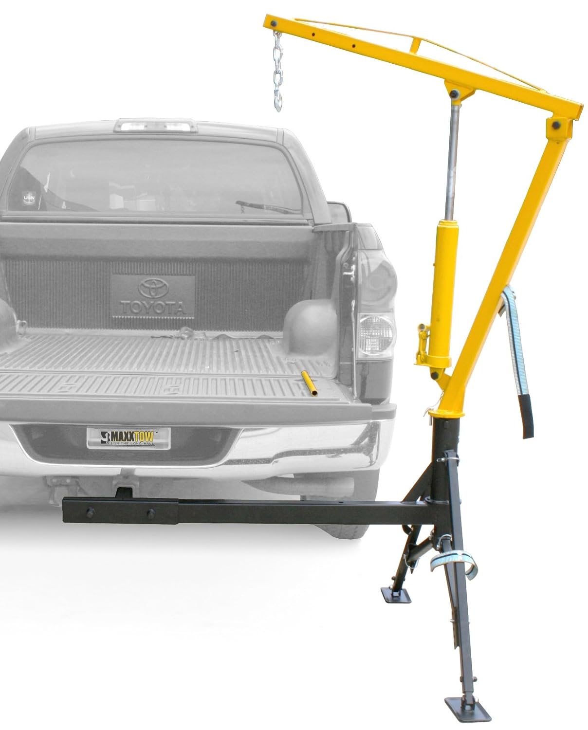

Reply:Well, if you know a fella who might be handy with welding and such stuff,  you could possibly cobble something together that looks kinda like this.....
There are lots of different models available commercially, and I'm sure there must be one or two in the Great White North.
The key to the design is having the outriggers to take the weight straight down to the ground.  Without that, hitch cranes aren't worth diddly.Of course, if you see this being a regular occurrence, I highly recommend going the route of everyone's buddy, Essential Craftsman, and outfitting your Tool Tank accordingly.....
Reply:Thanks for posting the vid, Vaughn!   I really liked that sloped height adjustment for the trailer hitch receiver to eliminate rattle. Sent from my iPad using Tapatalk:
