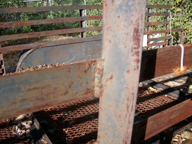

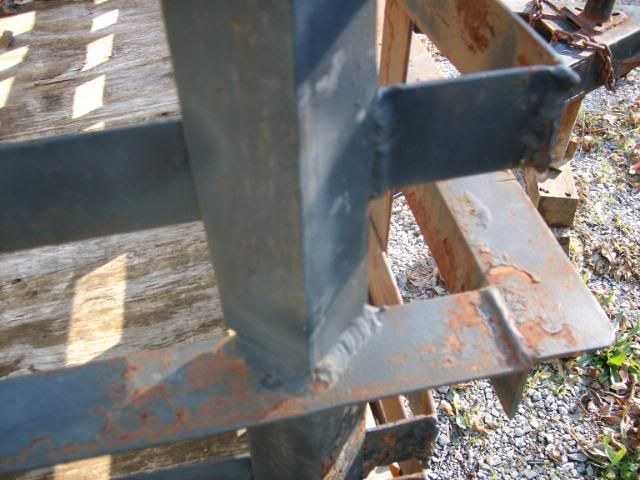

Reply:Pictures! I mentioned the rain in another post. Here is what I tacked with the torch. It's already painted though, and sort of a temporary/semi-permanent fix...cart handle. Right on the edges, I want to try some more with the torch, it makes for a nice change in pace compared to mig welding on the time-clock!

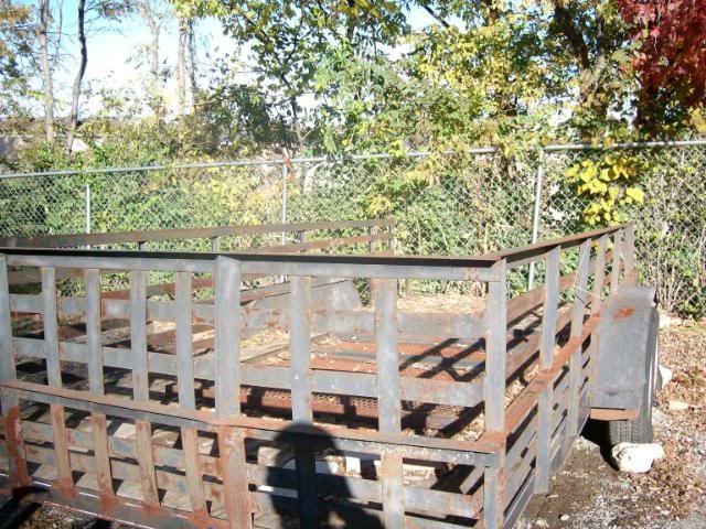

Reply:Here is a project I did about 8 yrs ago.  I was at the clients office and saw the old trailer sitting there.  ...bring back not so fond memories fo a couple of crazy hot days made hotter with the torch.  I just added all the strap and top angle.
