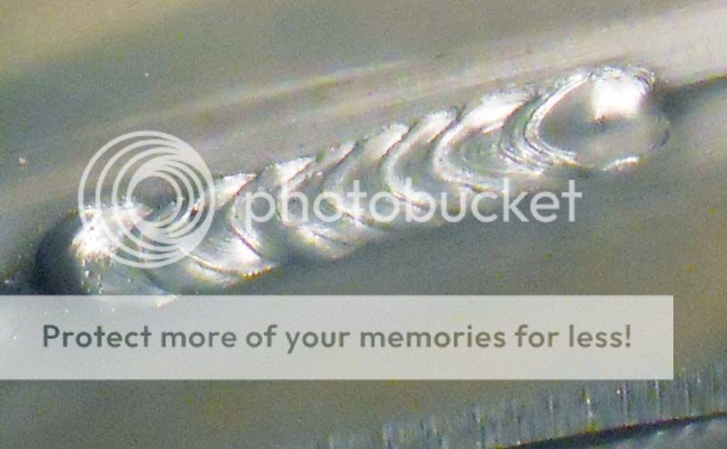

Anyway, having never welded aluminum or used spray transfer before (though I read a lot about both here), I'm not really sure what to look or listen for. I've heard about the hiss, and I definitely heard a bunch of different sounds as I played with the settings on the TB280 and tried pushing, pulling, forward 2-back 1, steady and straight, C-shaped and every other technique I've ever used (on steel). I still don't know if I did any of them right.
Reply:Here are some great arc shots of what aluminum spray transfer should look like:If I remember correctly this one shows the good and bad - lots of information on setting up:http://www.youtube.com/watch?feature...&v=8AT4cEHtMn8Dave J.Dave J.Beware of false knowledge; it is more dangerous than ignorance. ~George Bernard Shaw~ Syncro 350Invertec v250-sThermal Arc 161 and 300MM210DialarcTried being normal once, didn't take....I think it was a Tuesday.

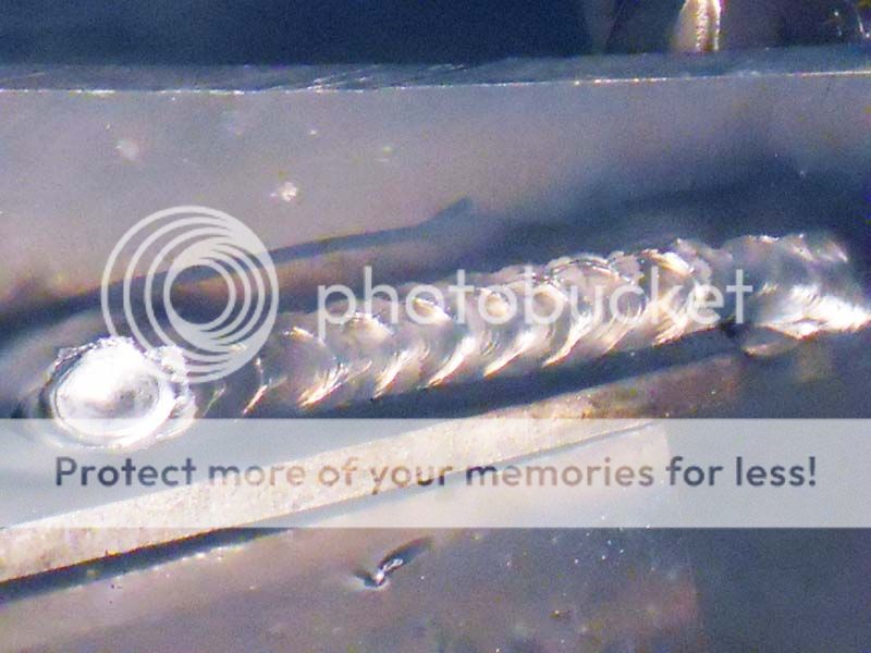

Reply:I was also wondering if I could get some expert opinions about the weld quality below. These new plates are blocking the hole where the exhaust used to exit the boat; we're relocating the exhaust to midships. The fellow who's doing the work is a marine mechanic who does reasonably nice TIG welds with the Snap-On machine in his shop. The welds here are the same guy using my Miller TB280 and Spoolmatic 30A. I know it's hard to diagnose from pix, but I'd appreciate learned opinions on what you can see here.Cheers,Q
Reply:Yuck!
Reply:HA! Concise! I like it! lolCould you elaborate a bit, though? I think I see a crack along the top and it appears he was doing spot welds for most of the trip around. If they are unattractive but otherwise solid, I could maybe live with that. If unattractive = prone to failure, that's another issue.Cheers,Qq240z, this 'weld' has problems. to much wire feed rate for the amount of weld power (voltage in this case) shown by the overly bulged and not fused toe and  top of weld. @ 5:00 to 6:00 there is one stretch of 'acceptable' -not decent or good, but acceptable weld that is the toe and top are showing fusion of the puddle to the parent metal (there could be some undercutting?)  not clear- but the puddle to puddle definition shows continuity of fusion. There is another stretch from 3:20 to nearly 4:00 where a few puddles are correctly formed, although apparently by accident not intent, where the only correctly formed weld is placed.    However, even this set of four or five semi-acceptable puddles are marred by cold start and crater cracked ends with some porosity to boot. Almost all the rest of the weld shows puddle to puddle (the weld was 'buttered' poorly) cold fusion or 'cold lapping'. Almost all the starts and stops are cold lapped and not done correctly by the 'welder' (not even Jr. High shop student skill level).The voids are not really porosity they are actually places where the clean up /contamination of the parent metal gassed off so long the molten edge of the parent metal actually was prevented from flowing into the filler. Porosity is likely to be present if this weld were cut off the surface skin, not sanded or ground, but cut; there will be uniform Swiss cheese like consistency due the lack of joint fit, joint prep, joint design, clean up and welding technique which is totally unsuited for job.Now a 30A is the worst torch to try to weld this as the wt is high and therefore the agility of the torch is lowered, but this weld should been done with TIG. However if a MIG torch was the only choice it should have been done with full back up bars, and allowing a single pass down into teh parent metal to fully fuse to the consumable back up. Instead the weld is 'buttered' onto the filler and deck and built up cold with little fusion.This weld is an example of a poor welder because a good welder will decline to weld if he cannot do a good job.  If you can't do good work: don't do any work.  I know we all need to learn but that should be done on the bench not someone's boat. a more reliable weld to discuss below.
some things to look for in this uncleaned MIG weld.  There is a boundary of clean zone at the toe and top of weld, that shows the argon was cleaning the entire weld zone -no gas flow problems. 5356 Wire soots as the magnesium alloy component vaporizes outside the argon envelope.   The top and toe of the weld 'flow into' the parent metal, they don't  ball up- and the flow lines disappear into the parent metal without a big ridge or undercut.  So this weld was balanced in terms of weld wattage- to melt the wire at this rate combine with the rate that arc melted wire filler was added to the melted parent in the molten metal.  The weld you show above was not adjusted correctly.Also the puddle to puddle ridges are present but only ridges not overlapping 'scales' of cold lapped metal, so the puddle movement of the arc/wire filler happened while the puddle was molten; not cold lapping.The start was done on a small 'run on strip' to take up the cold part of the beginning more or less an aluminum MIG technique.  And the stop was 'doubled back' on itself so the crater (normal to aluminum MIG stops) is only on top of a previous weld puddle already frozen and that is mostly cut out with carbide cutters to leave room to initiate the next or 'tie-in' weld.
This weld is just  a bit 'too cold' that is; the voltage is slightly too low. Why?  first the ridges aren't flowing into one another- they're just a bit too pronounced- indicating a small amount of edge cold lapping.  In other words with this weld setting movement of the gas cup/wire arc is moving over semi-chilled metal not just providing a movement within the molten puddle.   Second; the toe and top fusion is just curling back not much- but enough to indicate that we should either; slow the wire; or crank the voltage; or pull up the cup a fraction, all of which will add the adjustment to get a more fused weld.   The bottom edge is much better at this than the top so it may have been a matter of torch angle into the joint, where more arc should have been aimed to the upper leg?
This is the best way to do hull and deck patch repairs. The back up material would be fully consumed in a weld were the root face would be fused into the bottom or back up material. I realize that not all repairs get this level of attention but it is the right way to do the work.The edges would be cleaned back inches inside and out, any old weld cut cleanly out back into parent material not just ground off or sanded smooth and the repair weld would go ahead on 'new' parent material not like the weld shown where likely some of the old weld porosity bubbled into the new 'weld'. This works well for 3/16" and thinner repairs but should have top edges beveled back for any materiel thicker than that.Not sure if you wanted this blunt a statement about that weld (?) but if you've gone to the effort to do the nicely done sheer clamp in pretty pieces of dead tropical plants; it seems a shame to allow the other trades to be at lower standards?cheers,Kevin MorinKenai, AK
Reply:Thanks, Kevin. I appreciate your informative and blunt reply. I've been concerned for a while that the main reason my repower is nine months behind schedule is because this fellow just doesn't have the experience his mouth thinks he's got. I have a day job and don't have time to become as proficient with certain technical skills as I think are necessary. It's one thing to fire up the Millermatic 35 and do sheetmetal work on an old car, and quite another to weld aluminum in mission critical spots. That's why I call in the pros when things need to get done and done right.I think I'm at the point of telling this fellow he's off the job.Know any aluminum welders in Maryland? My Trailblazer runs fine, and it will power a TIG if the Spoolmatic's the wrong tool for the job. I have no problem saying I don't have the skills to do it.It's always something...ThxQ
Reply:Yikes.....fired and money refunded for that job.Wow.Dave J.Dave J.Beware of false knowledge; it is more dangerous than ignorance. ~George Bernard Shaw~ Syncro 350Invertec v250-sThermal Arc 161 and 300MM210DialarcTried being normal once, didn't take....I think it was a Tuesday.
Reply:Dave, the last job he did ended with him complaining about the Miller equipment being junk and pointing to one part of the job he'd done (that looked kind of like the 5-6 o'clock area in the pic I just posted) and calling it a "stack of dimes" weld.I'd never welded aluminum before but have had a Millermatic 35 for a few decades. I'll tell you what, my aluminum welds after an hour of practice with the same TB280 and Spoolmatic looked far better than his "stack of dimes." I didn't say it at the time, but I felt like telling him dimes don't look like that where I'm from... but used toilet paper does.I'm getting tired of firing highly paid American craftsmen for junk work. gadQ
Reply:You have expensive, critical welds to make - consider giving them a couple of test pieces to weld.Many welders have to test on the job - you being the employer is no different in my opinion.One job I asked for scrap of the aluminum they wanted welded and gave them sample welds the next day for inspection.  If I'm willing to offer to make sample welds to get a job, you should feel comfortable requiring them on your equipment with your material.Dave J.Dave J.Beware of false knowledge; it is more dangerous than ignorance. ~George Bernard Shaw~ Syncro 350Invertec v250-sThermal Arc 161 and 300MM210DialarcTried being normal once, didn't take....I think it was a Tuesday.
Reply:q240z, glad I wasn't considered rude, and glad you're considering another welder.I'd say we need a touch of perspective here, we have on here (just one of many sites) lots of welders of extraordinary skill whose knowledge allows good work for their clients.  I'd say perhaps you may want to tighten up your contractor hiring procedures just a bit?  First, if the welder doesn't have their own equipment then that alone should say something about their qualifications to join your project?  It does to me, that welder is not committed enough to the trade to provide his own machine- fine with me; but I'm not hiring someone with that attitude/practice/policy/work ethic to come work on my boat!Next, a work sample/weld test/break bend test run with your own equipment, if that is the only tool for this particular job, is not out of line.  So if they can't weld up, down, left, right, butt, outside fillet, inside fillet: why would you consider them an "American craftsman"?  Let's call them what that group is, wanna-bee's who can't weld- yet.   (hopefully) They may develop into fine craftsman but if you can't have an onsite demo - you're being too generous with your terminology and not stringent enough with your hiring standards.This guy must not be sought after enough to have fulltime MIG gig for a local aluminum shop? Otherwise why is he lose to work for you?If they can't make a decent bend break test in plate, you sure as shootin' don't want them on your boat!  I don't care for the 30A, I prefer the push pull MK guns- but I can weld with the Miller "club"- if required.  (perhaps being threatened with a beating using that particular MIG gun would induce me to pick one up... but not if I could avoid it.)  I'm not saying the 30A won't weld, but I am saying the gun is huge for any kind of close quarters, out of position, or small size circular or rolled welds that require high degree of welder motion to make the weld.But the measure of the man, in my opinion, was to take on your work, knowing the welds to be done and the equipment to do it... that is #1 dishonest or #2 so lacking in experience that they should not have been considered or #3 so unaware of good work the welded didn't know any better?I often tell young aluminum MIG welders " if you aren't between the lines you don't keep driving your car do you?"  So if you're clearly in the 'ditch' beside the road instead of on the road, why do you keep putting down a bead: that is worse than driving in the ditch????It's not going to get better: stop. Something is wrong so you need to figure that out on scrap before you go ahead.Your man needs to be let go, you need to hire more carefully and remember all welders claim to be able to weld " Anything but the Crack of Dawn and a Broken Heart".  "Why!! if you can jump a stallion over that gap at a full gallop; I can weld that sum'b**ch!" So "Trust but Verify" and that's what a weld test is.  You need to test any future welder to make sure he/she can do what you need done.  If you don't then you're making your own problems. If the work is done wrong (done once) you'll have to take it out (done twice) and then do it again (done three times) so it can be said its three times faster to the job right: once.Cheers,Kevin Morin
Reply:Dave and Kevin, I really do appreciate the responses.The deal is, this guy is a Naval Academy-trained marine engineer. Or maybe I should say allegedly, since I haven't seen the actual sheepskin. He's got a very well equipped shop, with a 5" capacity shaft lathe, milling machine, Snap On MIG and TIG machines etc. I've seen both stainless and aluminum work come out of his shop and it's all looked pretty good. I'd say he's a marine mechanic/machinist with good welding machines in the shop as opposed to him being a "welder." I hope that makes sense.I got the TB280 and Spoolmatic because it's a big aluminum boat project and I've always been a DIY type. Also, there's lousy power supply out in the boatyard, so it made sense to get a welding power supply that can also output 240vac. I wouldn't think twice about firing it up to weld a non-critical bracket, but we're talking cutlass bearing housings and the hull near the waterline. That's the point where I want a pro to do it right.Anyway, I sent him an email with "All stop" in the subject line. He called back and we had words...tried to keep it short and professional. He said there was "good penetration" and that the welds would "grind down nice and flat." I was tempted to quote some observations that were made here, but decided not to. I know he'll talk smack about me no matter what  (it's kind of a small town), but I don't want to hurt the guy's feelings any more than necessary. It'll be interesting to see the final bill...I've been on the phone to a few local welders and have already nixed two from the possible pool.You know...what I need is one of those things from the movie The Matrix where you plug something into your head and next thing you know, you're a kung fu master. I need that, but with advanced MIG/TIG training! lolQLast edited by q240z; 07-02-2013 at 03:13 PM.
Reply:In the shop is different than spool gun at the dock.Make them show you they can dial it in perfect.  On site test required.If they say they need an hour to experiment with your machine before showing you welds, I'd say let them.Dave J.Dave J.Beware of false knowledge; it is more dangerous than ignorance. ~George Bernard Shaw~ Syncro 350Invertec v250-sThermal Arc 161 and 300MM210DialarcTried being normal once, didn't take....I think it was a Tuesday.
Reply:I was looking at his settings on my TB280 today. 3/16" plate and the amps were dialed down to 80. Seems kinda low to me.  He also cranked the wire tension thumbscrew inside the gun so tight that the tensioner couldn't be pushed "home." This is with .35" wire.  Last time he welded with it, he had it cranked up to 210 and was burning up tips like crazy (and blaming the machine). I set it at 140 and played with the wire feed until it seemed to be welding better. You guys would have had good cause to rip into my welds, too, but they looked better than his!Oh, and I just got the final bill. It includes the hour or so he spent playing with the machine to learn how it works and 4 hours to weld in the plate in the exhaust hole in that pic I posted.
