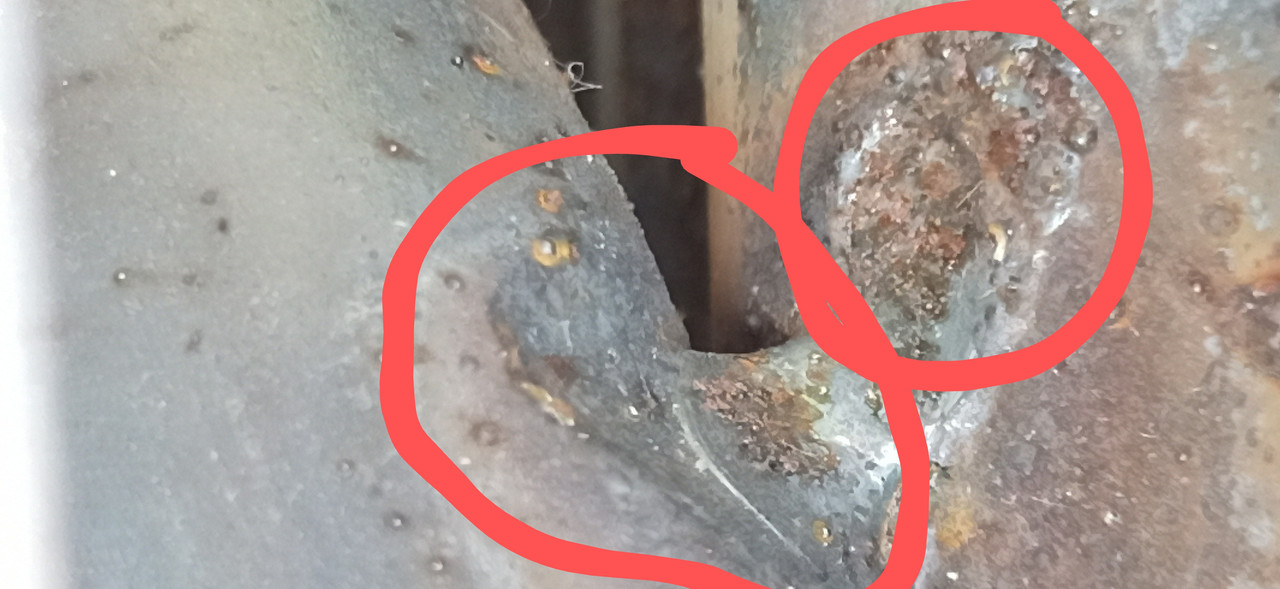

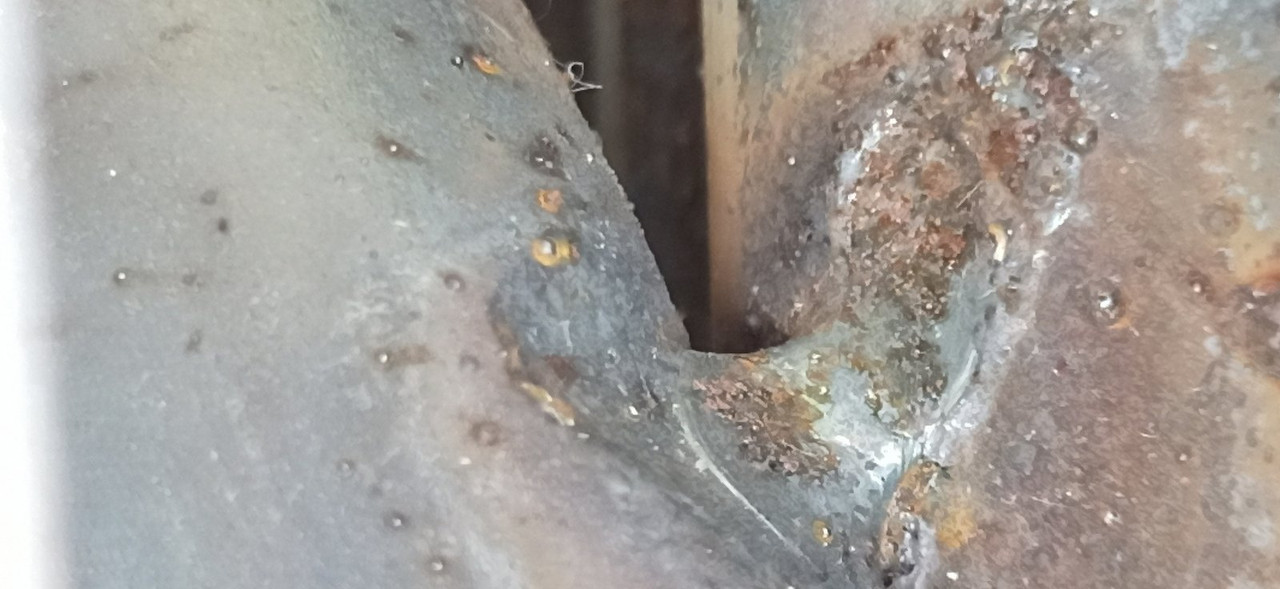

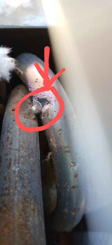

Hello guys and gals. Our pressure washing company recently purchased a boiler for high pressure hot water applications. I was inspecting the unit when I noticed two questionable places in the boiler pipe. This unis is essentially a schedule 80 1/2" id steel pipe coil with the burner heating it up while 4000 psi water travels through it. So the pipe is a subject to 4000 (up to 6000 psi) 250 degree water.My question regarding this pipe, is it even legal to run something like this under the pressure? Are pressure pipes suppose to be inspected? What are the legal tolerance on undercut on a pressure vessel? Area of concern are those two tack places. One is gouged out and other near melted through the pipe itself (looks like wall of the pipe caved in).Would like to hear your opinions on this weld/tack job. Appreciate your input!!

It's a schedule 80 pipe in 1/2" ID. These pictures are taken through the exhaust of the unit and are not immediately visible without looking through the exhaust and using macro to get to the pipe. And this IS a brand new unit thus the question about acceptable undercut. Wouldn't even look at this if it was a used and tested rig.

Originally Posted by MichaelA2014
Thank you for the input. I can tig it up but I don't think I need to take the unit apart. We paid full retail price for the top of the line hot box. I shouldn't have to take it apart and fix it before it even been turned on. The quality control is null. Plus to take it apart I will have to cut the stainless coil wrap and possibly tear off kaowool to inspect the rest of the coil and this isn't something I am willing to do. We are in the pressure washing business and not a coil repair one
The question remains, is this damage within tolerance of ASME standards or not for the half inch schedule 80 pipe working under 4-5000 psi at 250 Degree water.
Reply:First of all it’s a heated pressure washer not a boiler. It doesn’t need to be inspected it’s water not steam! 6000 psi isn’t **** we run that in  schedule 40 pipe in hydraulic systems. Water unlike steam, air, ect is incompressible therefore it doesn’t store energy like gas does (basically a spring) so if/when that coil blows it won’t be any different then a hydraulic line busting (actually better there won’t be any oil to clean up). I’d leave it alone if it blows and starts leaking then fix it.
Reply:The spot with the torn out tack is probably below the corrosion allowance for steel pressure pipe so I would recommend you tig that up if you're able. The others I wouldn't worry about.

Reply:325 degrees and no one suggested it gets done with a coat hanger.  I will agree its probably within the allowance and in that area its not likely to be a problem.  I would likely fix it but am confident in the ability.    While this is under pressure and heat its not quite the same as a vessel.  If it can be blown up it wont have a thing to do with that weld.  We didnt have net when I was working on these regular but I have repaired leaks in them. When I do I treat it dssurgically due to the azzhole spots they can be in and its kind of a 1 shot fix if you cant get at it.   As for the net, as I mention we didnt have it so I never researched the risk but I aint the only one that keep a whole fleet of them running.  I never heard of one blowing up but shate goes wrong with them all the time and are operator sensitive.  I have never made steam with mine and am on the original coils and still works well, bought in 84 new.   There is no inspection date required, most are operated with minimal training really and human error is the main concern, I bout overheated my build a could times for I figured out a couple things I miss due to human error, miswire a switch I have done a hundred times etc.   I remember 1 where they worry up a storm and have the local vessel shop try it, guy sticks a rod in and burns a hole.  Turns out, no one has one even at some astronomical price, guy was pissed I charge 8 for fixing it for a 30 second weld.  I made a big deal out of it took it out of the truck, thought they might replace it and was hoping for the core.   At the time the bill was 600 or so and got,,, the last guy only charged 75,,,, didnt grasp that it didnt work.  You would think a guy would be grateful, I forget what it cost then but million btu burner and put it back to work when it was booked solid.Last edited by Sberry; 3 Days Ago at 11:25 AM.www.urkafarms.com
Reply:I think I might fix that popped tack and not sure I would connect it. Easy now, a mess when it leaks.   A thing to remember this is shielded when in operation, a failure is going to be a leak. Not the same as a whole vessel  where the containment and shell is under pressure and can rocket up exponentially.  I was off and on oilpatch for a decades, vessel has a stamp, must be serviced with code but they let monkeys work on the pipe.  Lots of 2 inch.www.urkafarms.com

It's not a popped up tack. It looks like one but it isn't. Thats a gouged out metal from sloppy mig operator.
