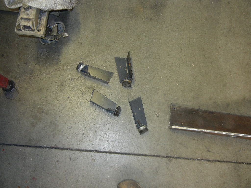

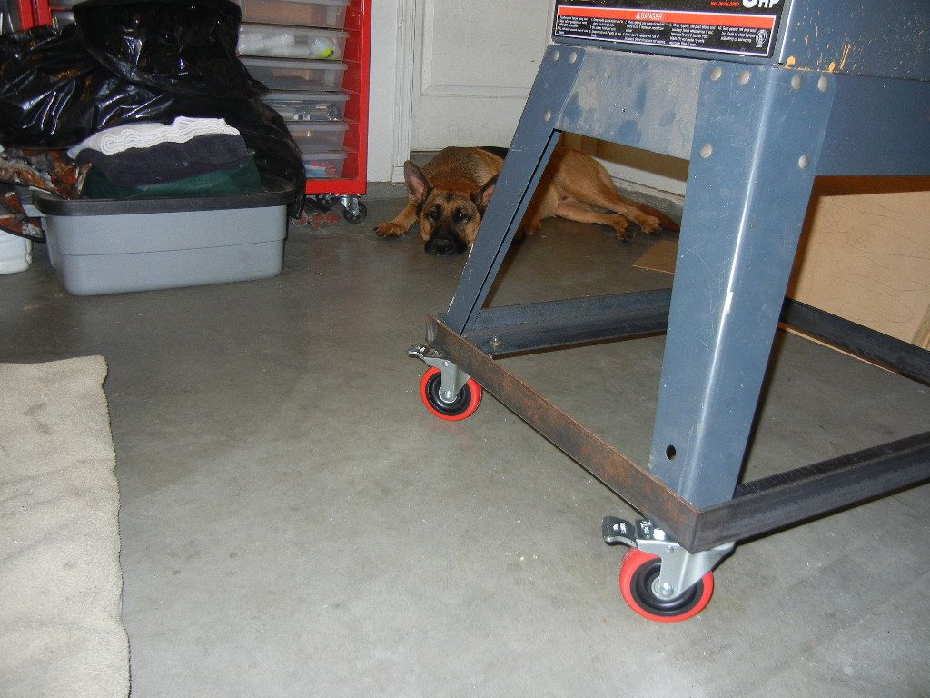

Reply:I did this for a Sear POS saw, cut the legs down built the base and installed the casters to the base, wheels are the double lock and its rock solid.

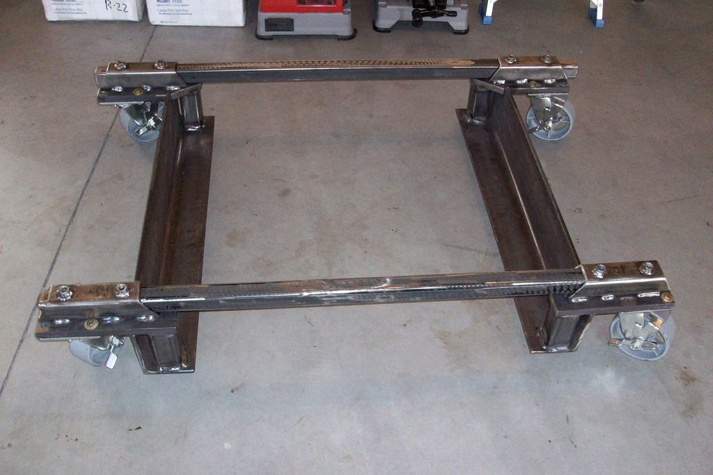

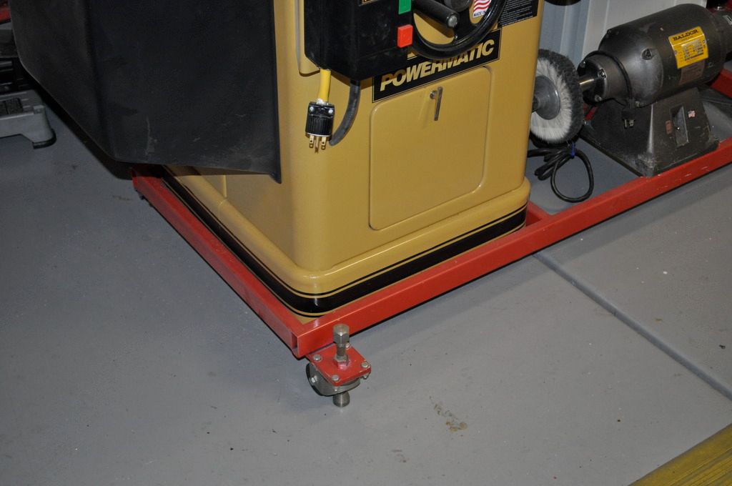

Reply:I have some 3 wheeled bases made by a company called HTC. The bases are very stable and strong. I made a knockoff for my jointer based on their design. I'll post some photos tomorrow.
I found some pictures I could attach tonight. Everyone I know who has these bases is very happy with them. Hope this helps.

Reply:Yes, they are very stable. The screws lockdown the wheels.I have this type of mobile base under my tablesaw, my planer, my bandsaw and now my jointer. The first three were made by HTC. The fourth one I made as a knockoff of their design. I put a hinge inside the wheel box. The hinge is fixed to the wheel box and just lays on top of the caster. The T-bolt pushes down on the hinge and puts pressure on the caster. That way the T-bolts do not dig into the casters.

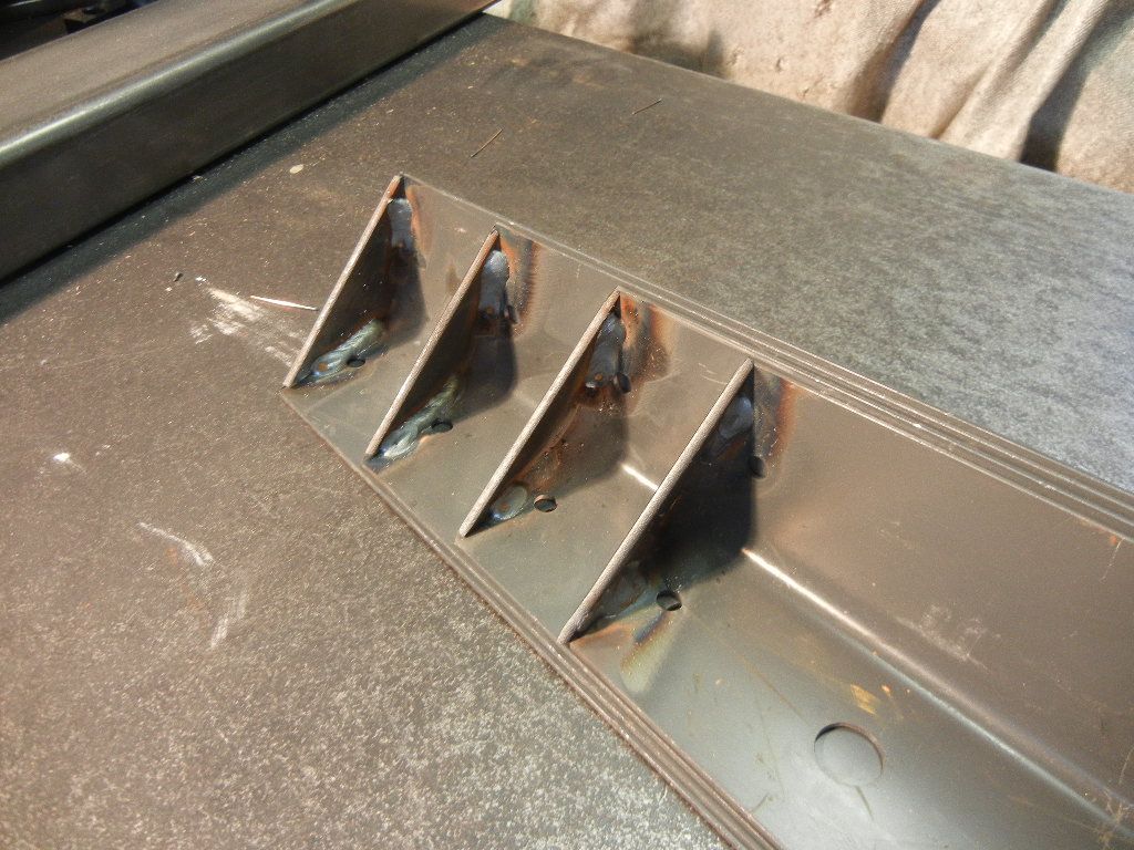

Reply:Here's what I'm going to be building Monday. It's my version of the HTC bases shown by RWH. The tube will be 16ga 2x3 and the plates will be 11ga with 1x1/8 stiffeners. The pictures don't show the locking mechanism for the fixed casters, but it will consist of an upside down carriage that will push down on the top of the wheel. I am hoping the domed head will keep it from digging into the caster wheel's rubber.
