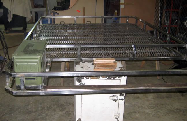

I thought I would post up one of my projects I have done.  I built this for my Hummer H2, as I was not satisfied with the available racks, and did not really like the $2500 they wanted for one this size.I thought about many different options, and chose to go with square tubing instead of round.  I think it suits the Hummer better, since the Hummer is a very square, angular design.  It took about 6 months of working mornings before work and weekends.Main tools were Hobart Handler 140 MIG and JET band saw.I built a quick jig for assembling the corners.  It worked well, as the frame came out dead on square.

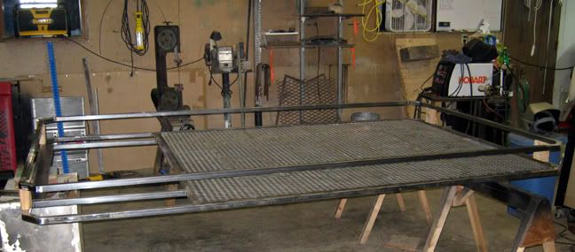

Here is the corner jig in action:

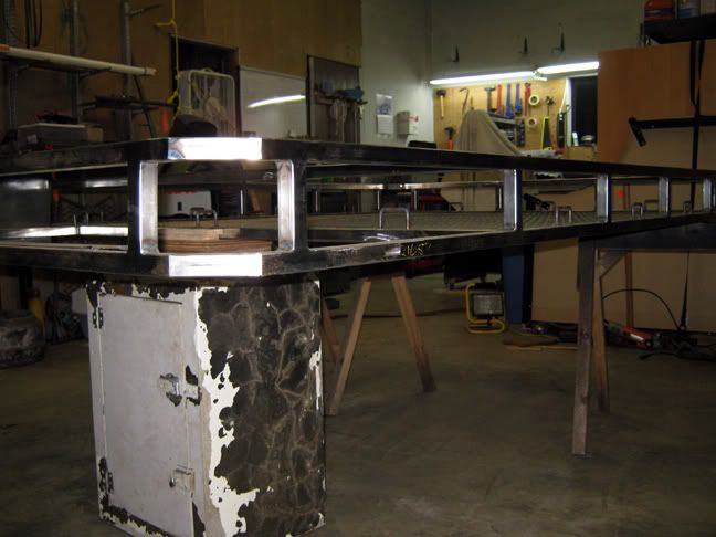

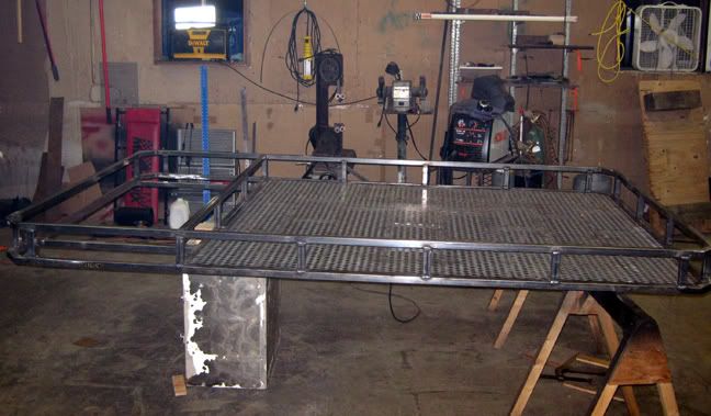

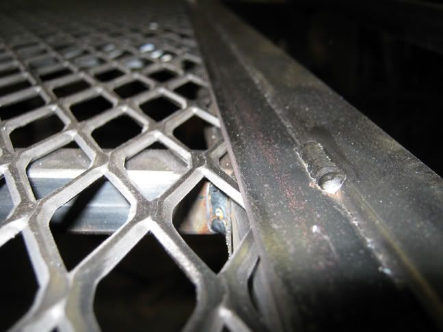

I used 3/4" tubing to go all around the cargo area.  This will add more strength to the frame, and also makes a shelf for the gratting to sit on.  Then I put in the cross pieces and added bracing in between them.  Here it is with the 3/4" in around the cargo area and the cross bars:
Here it is with the other bracing added:

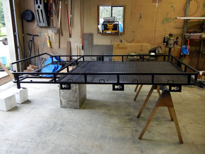

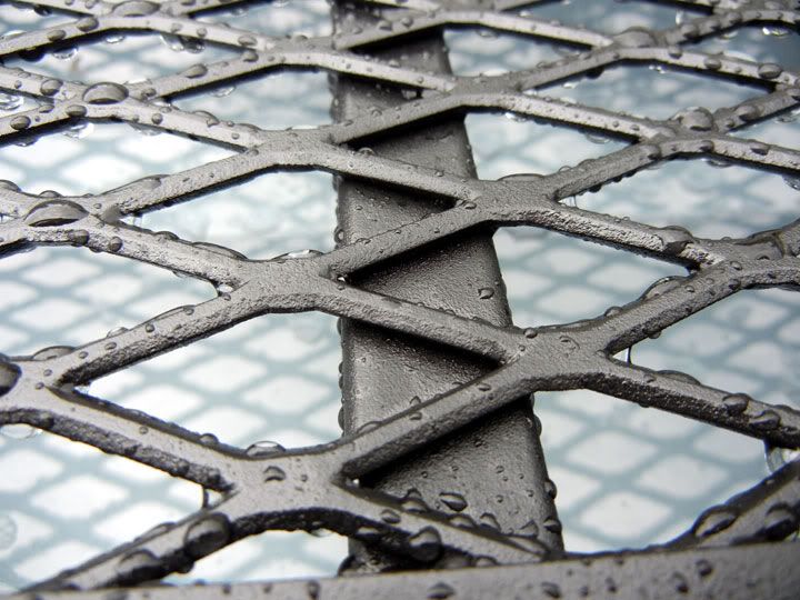

Ok, here is a pic with the grating welded in.

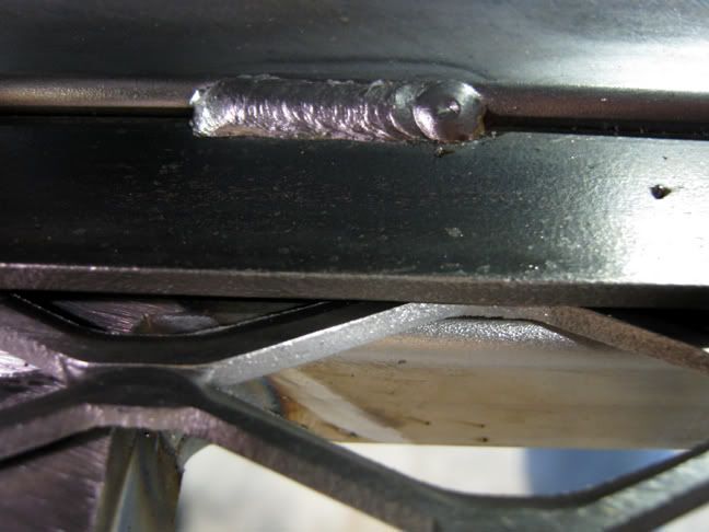

Reply:Here are a couple shots of the strapping around the edge to show how it went together:
The rail on it.
I eventually changed the front of the rail. I cut it and angled it up for more space for lights.

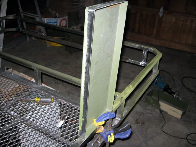

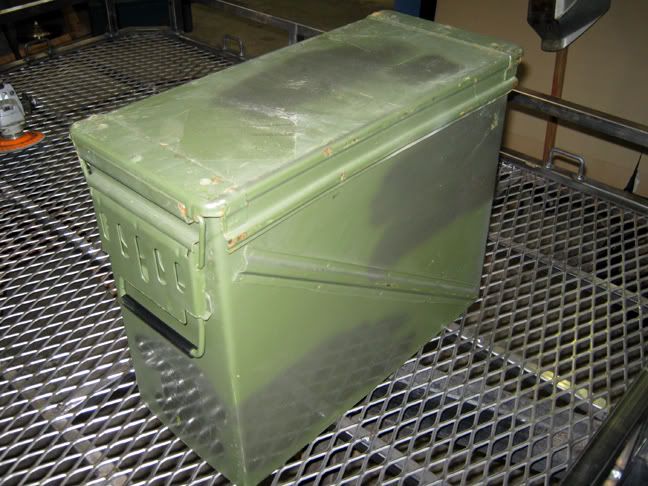

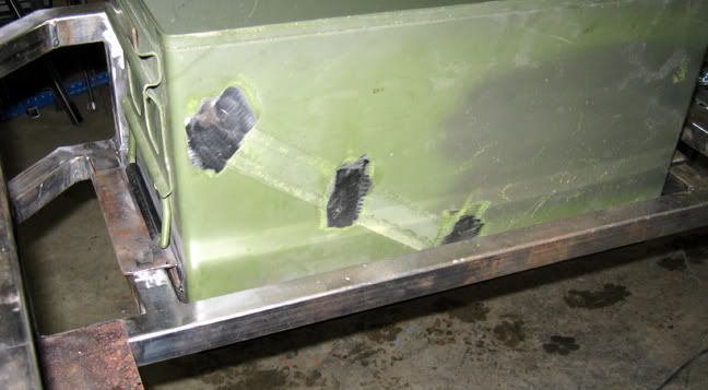

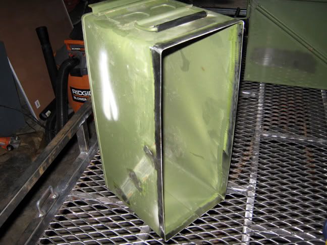

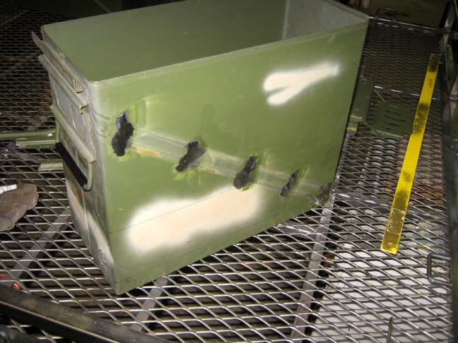

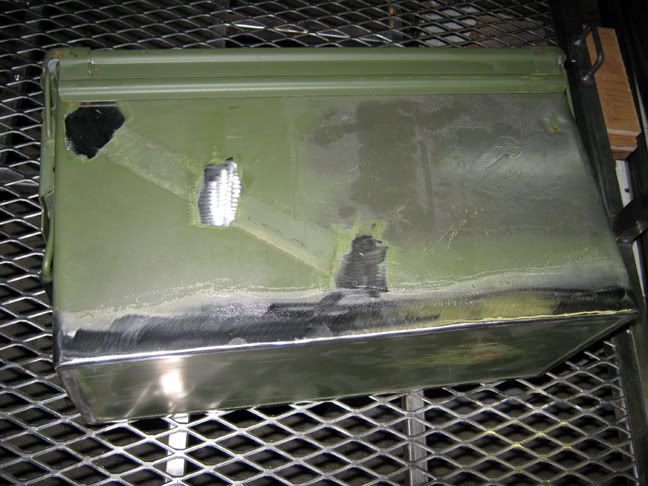

Reply:I decided to go with storage boxes in the front corners, but thought for a long time on how or what to make them with. I wanted them water tight. Then I looked around in my shop and came up with great idea. I had an old 20MM ammo can. They have rubber seals in the lid and are water tight. It was the perfect width and length, but too tall. I went and picked up two new ones in good shape. I cut the stiffeners off the side and cut the bottoms off. Then I cut about 5" off the sides, and welded the bottoms back on. I also made and installed tie-down points around the edge of the cargo area. They are made from 5/16" round stock, but in keeping with the design theme, I made them square.The pre-mod can:
Stiffener removed:
Bottom cut off:
Welded back together:

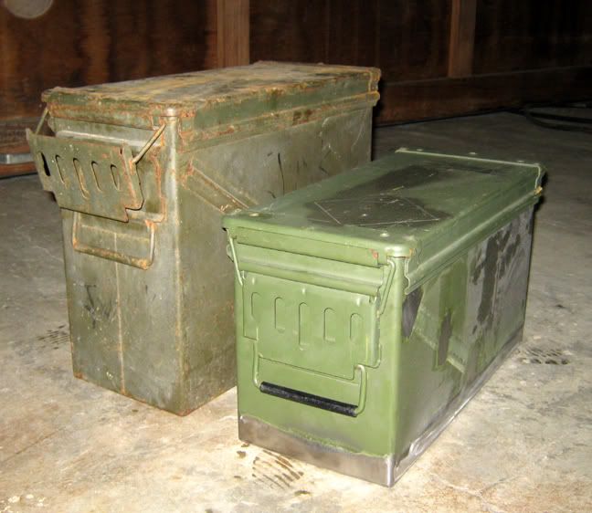

Modded can next to the old cruddy one that inspired the idea:
Here is how they will sit. This one is just suspended with wire at the moment for looks:

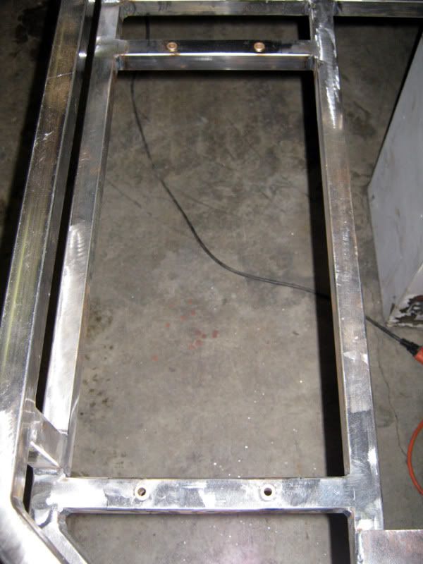

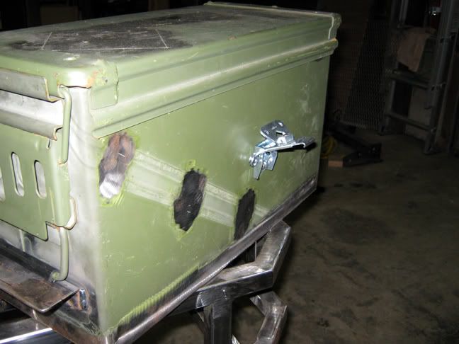

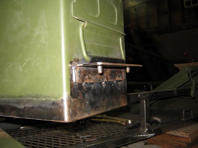

Reply:The tie-down points:

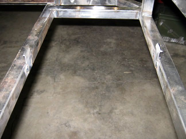

After much thinking and rethinking, I came up with what I think is a pretty good way to secure the boxes and yet easily remove them if needed. I welded an angle bracket on each end of the box, drilled two holes in each one, and made little alignment pins from 1/4" round stock and welded them into the holes.

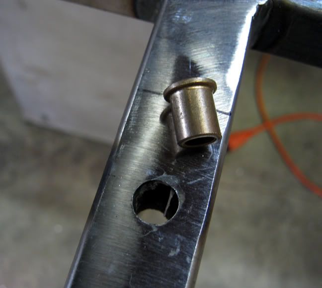

I drilled two 1/2" holes in the cross bars that the angles sit on that line up with the alignment pins. I cut a length of 1/2" OD 3/8" ID tubing and welded them into the holes. Now the square tubing is still sealed up. Plus, with the holes going all the way through, they will never get plugged up with ice, dirt, etc.
I got some bronze bushings that were 3/8" OD and 1/4" ID, and put them in the holes in the cross bars:
The box now sits with the pins inside the bushings:
After much searching, I was able to find a place to order some rotary draw latches. I mounted them to the sides of the box:
I made keepers for the latches and welded them to the frame:

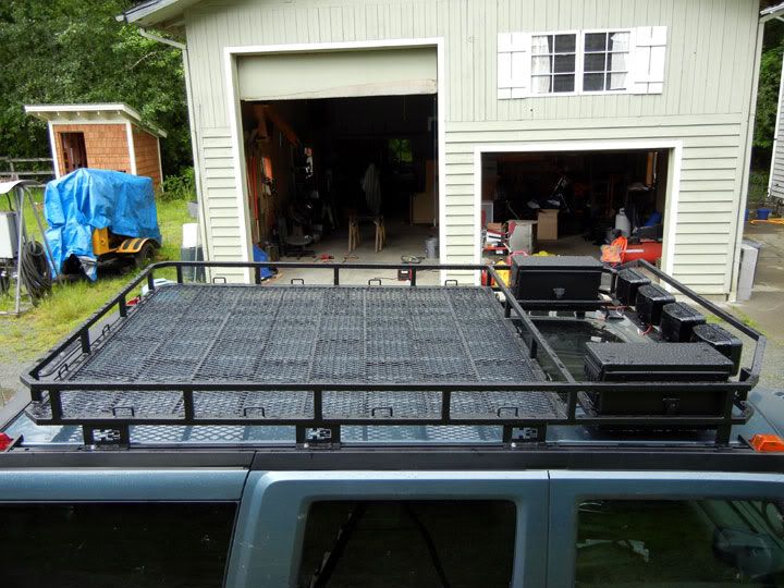

Reply:And now the box sets down on the frame into the alignment holes. Then you just give the latches a half turn and it is cinched down tight. The box feels like it is welded on it is so solid when it's latched down. But it can be removed in about 5-10 seconds.

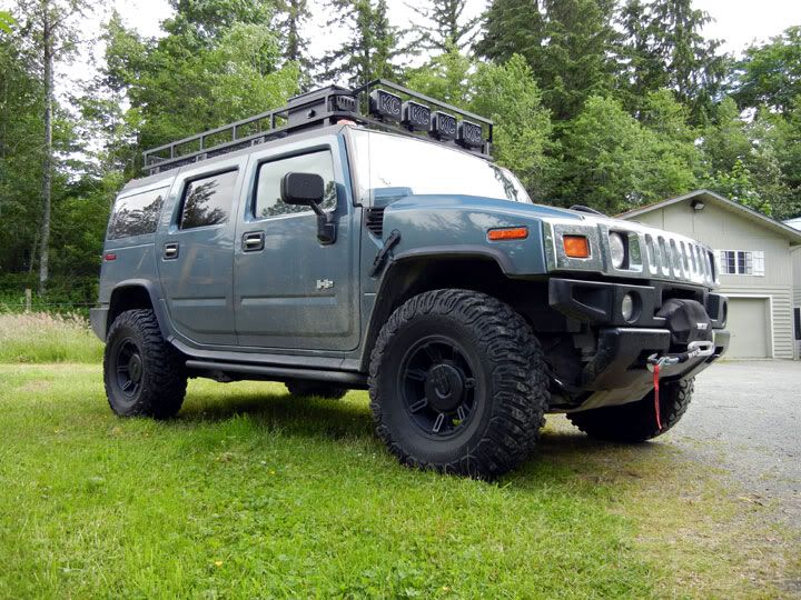

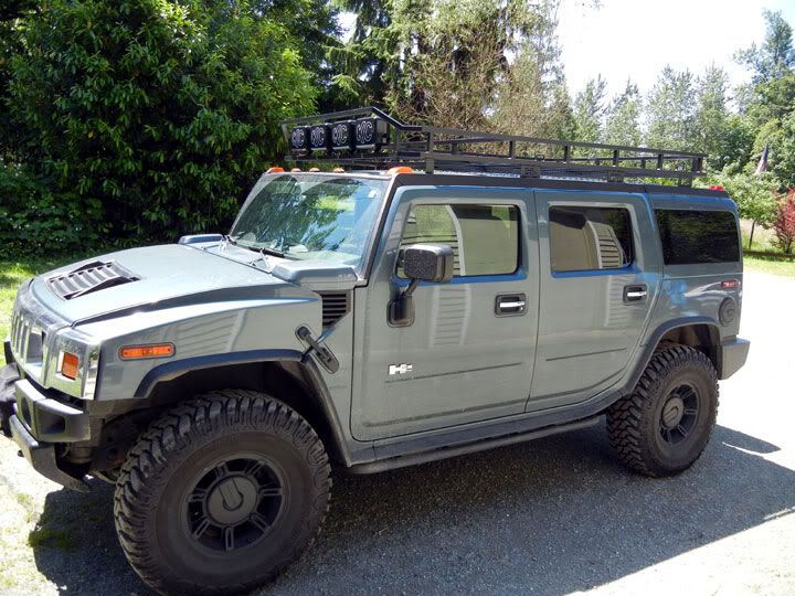

This was the first time I had the boxes in with it up on the truck. I thought it was going to look ok with them on, it looks better than I imagined. I think once it is all finished in black it is going to be awesome and very custom looking. They only take about a minute each to put on or off.

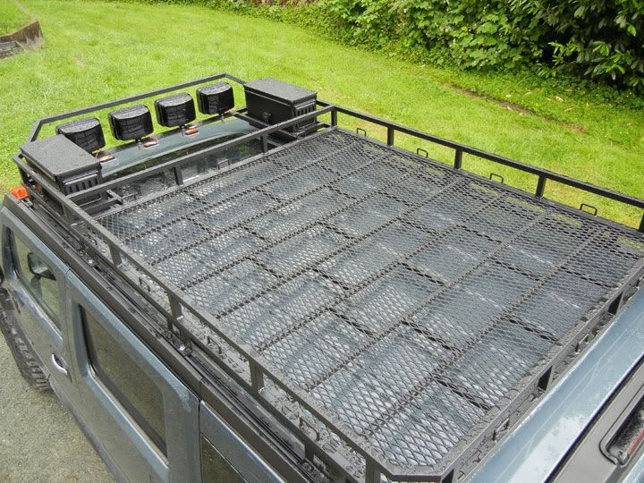

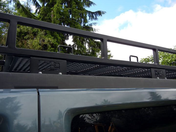

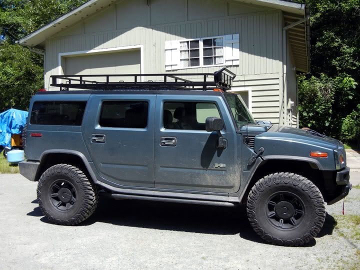

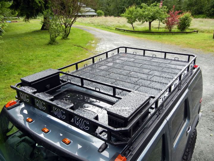

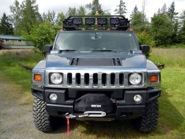

Reply:And now, the final product.  You will also note that I had the chrome fuel door blasted and powder coated black as well! Here it is unloaded from the trailer.
Lights mounted:

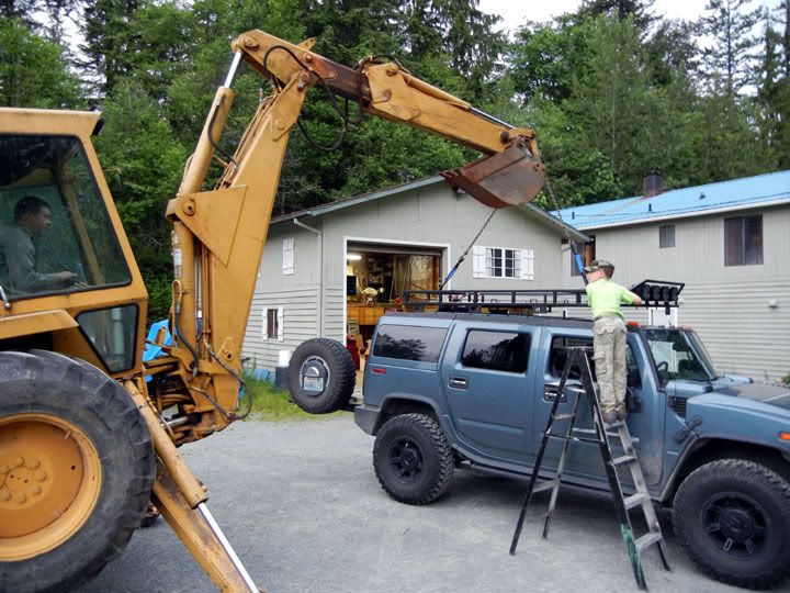

Setting it in place with my professional crew:
And done! Here you can see the fuel door:
Prius' will tremble and wet themselves!
Here is a closer shot of the bracket. I think it gives a very subtle custom feel to it. They don't stand out really loud, they are a very subtle touch. I like it a lot!
  I already have a few things I would do different, but that will be for the next one! Maybe it will be aluminum!

Reply:Nice work.  Good patience too sticking to it over six months.  I'm not normally a fan of H2's, but yours looks good.edit:// I started posting before you had finished posting all the pictures.  Looking at the final shots, it came out great!!!  Ammo box modifications and mounting system is awesome.  Lots of little details you worked in there that add up to something very cool.Last edited by el bob; 03-24-2012 at 03:21 PM.

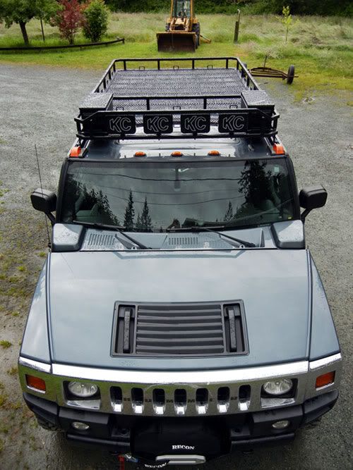

Here are some views from above so you can see the cargo area.
Here are a few shots with the boxes removed.

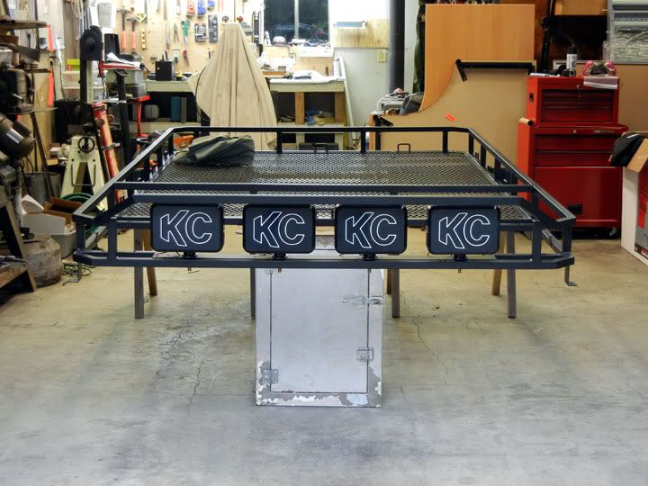

Reply:Here are some pics of some of the racks I have built for H3s.  They seem to be more popular than H2s.
I came up with an integrated jack mount design so that there are no extra parts to lose.  The leg just folds down into the deck when not being used, and is held by a spring so it wont rattle.
Here are the brackets I make myself now:
Reply:This one has shorter sides and no sunroof:
Did a ladder on this one:

Reply:I liked the way it made everything look clean by not showing the end of the expanded metal. Are u still hiding that if so how. Going to build something like this for my expedition
Reply:SIX MONTHS?? you got a lot of grit justme! that was an excellent build and great documentation. i really like the pic of you and the family on top of the rack.i.u.o.e. # 15queens, ny and sunny fla
