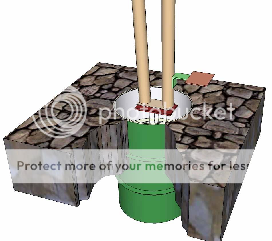

On another topic there's a discussion of erecting steel building where I'd remarked about building one from surplus pipe/tubing.In many area of the US 2" pipe (2-38" tubing) 2-1/2" pipe (2-7/8" tubing) and 3" (3-1/2" tubing) are available for low cost compared to buying structural steel.  If you were to purchase sched. 80 - L-80 steel it wouldn't make much sense to pay new costs to build a building when much less expensive and just as useful shapes of steel are readily available.But..... if you're long on time and have a welding machine and are interested, here is a look a doing it yourself. There are several keys to this post being useful. #1 the supply of surplus production tubing.  #2 the ability to handle it, cut and weld it into structural trusses.  #3 the lack of interference of officialdom; like building codes, inspectors, and other limitations on freedom of building what you want.Not everyone will have these three conditions, so if you don't this post will be more a curiosity or waste of time, please bear with.First, not everyone needs or can afford a full slab in their new shop.  Still you'd need some basic foundation so here are some thoughts.

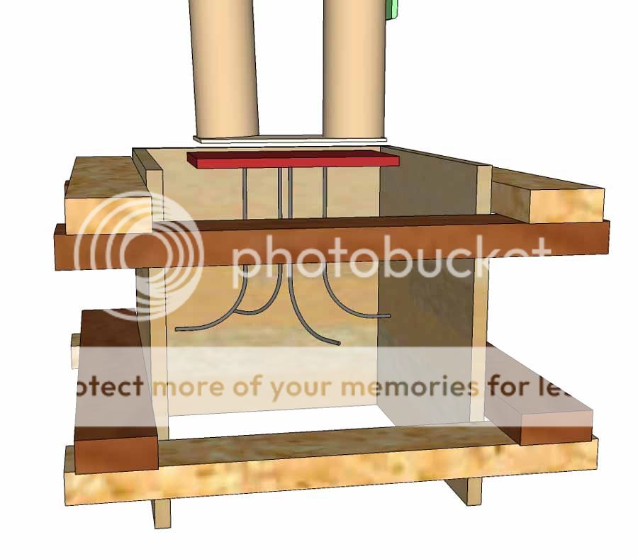

put a plywood box form together that will knock down and can be re-used.
the form is buried at (eventual grade) so you can cast a block of concrete as a post support.  This can be done with a wheel barrow or small mixer to conserve the costs of a ready mix truck, but if they were all buried and ready to go (?) the truck might be a faster answer?
Of course, no concrete form proposal or discussion is complete without considering a metal, pre-rolled, (maybe) pre-oiled, alternative form; to cast the building post bases.  These forms are readily available in some areas of the country, often coinciding with the presence of surplus tubing.In each of the post-only concrete images above I'm showing a plate with rebar welded below that is cast into the slab, the base pier or whatever will hold the framing post/columns.
Here a red steel plate with rebar welded to the bottom is shown with the eventual column base above it.  By casting the plate into the concrete and welding the column base to the slightly oversized base plate the foundation bolting routine is skipped.Some old Jet rod put in as a down hand, drag fillet, between these two pieces of plate will keep the column in place on most buildings.
the concrete surface is not shown in these images to make the parts more clear and less confusing in the pictures.

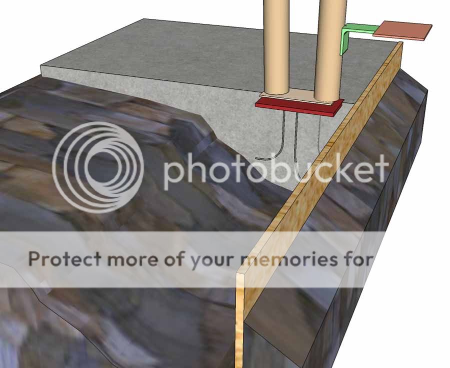

For those who can afford a slab, and will be using a footer as just a slab edge that is thicker, the same plate is shown cast in place.

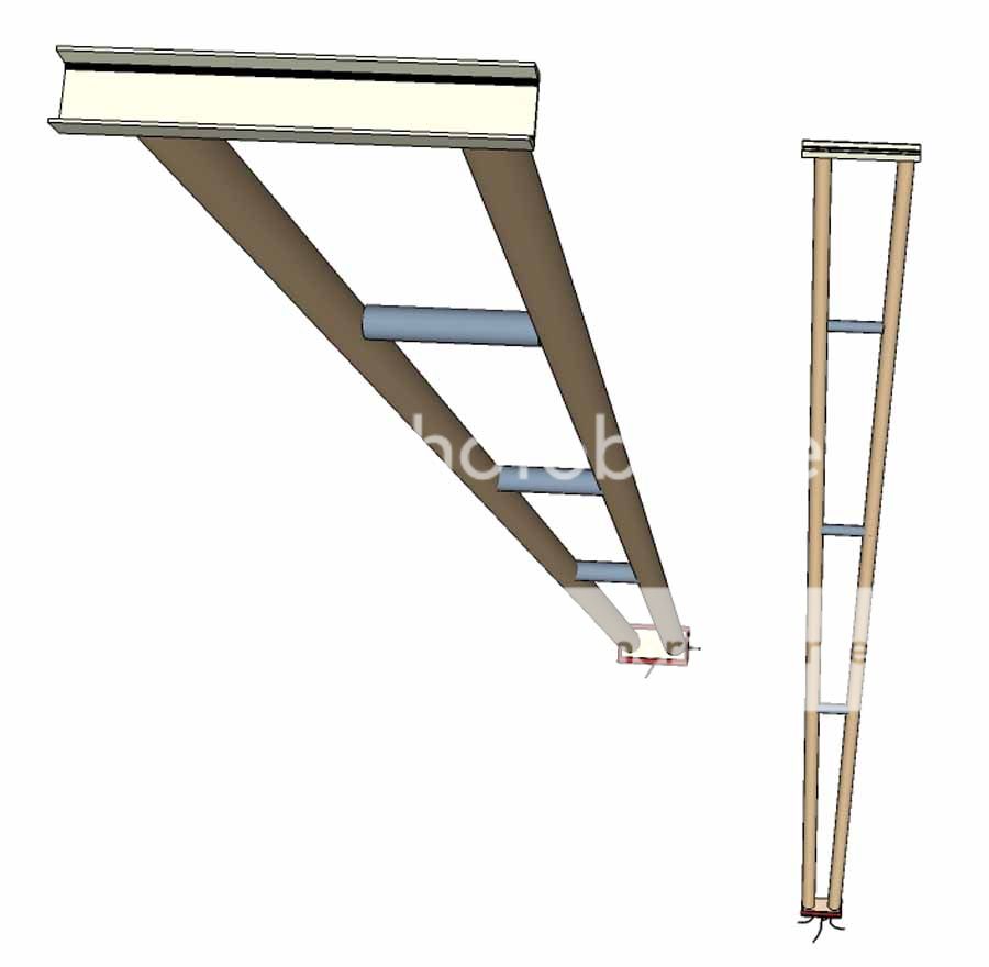

Columns of 3-1/2" pipe would get a little wobbly above 15 feet so double them up.  One shop I help build had no 3-1/2" only 2-7/8 (2-1/2" pipe) so the owner put four posts per column - "Just to be sure".  He'd only paid 0.50$ a foot; so four pipes per post only cost him $2.00 per foot of column and his welding time.   I believe the building is still up and the walls are 25'+ at the eaves.
To hang a pipe frame door, use the concentric sizes of the pipes and cut hinges and hinge stops.
Of course there are plenty of other ways to make the doors hinge, but this will allow the entire end wall to open up -if that were needed in your barn?

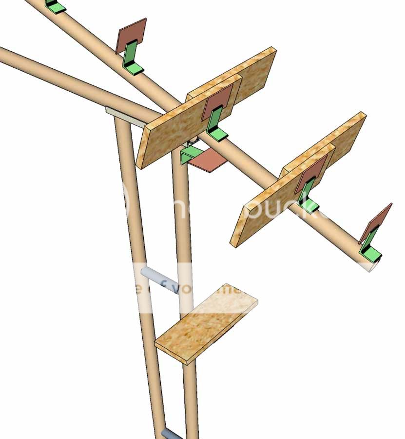

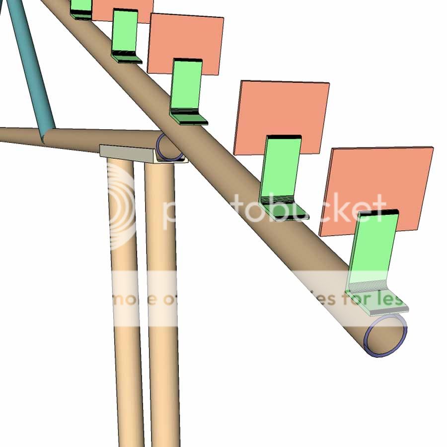

To attach purlins that will hold the sheeting, I go to the metal distributor and have them cut hundreds of unequal leg angle 'clip's or L's on their iron worker.  They usually keep the cost to 0.50$ per clip or less if you get a couple of hundred. (green angles)  Do the same with some 3/16" x 4" flat bar (red) and weld them together and drill two to four holes in the red plate.  The angles weld to the outer legs, truss tops, and any where else you'll need to have purlins for sheeting.Next postCheers,Kevin Morin
Reply:To add purlins, roof joists or whatever we call them they lay on the outer pipes and cross lap at the welded on angles.
At the ends  you can make the wooden purlins even with the front or back wall purlins surfaces, or overhand as needed for an eave line.  At the intermediate locations just overlap the two 2x8-2x10-2x12 depending on the span or spacing of your frame and loads.  Then climb the outside of the building and using a visegrip to hold the two boards to the steel plate drill for carriage bolts and tighten them up.
A quick look at a 20' wall on a 30' wide truss.
  Four 14' to 16' bays of pipe will be a nice little building 30' x 40 or so and with enough ceiling or overhead to put some decent equipment inside and strong enough to hoist a decent load.
Whether you make the trusses wide or narrow, use lots of pipes for columns of just a few, a well thought out poll barn can be a very low cost means of providing a welding shop.  I started out with the slab but I've added on a few times when I couldn't afford the slab so I've done them both ways.I used to build boats but couldn't afford a boat barn so I had to come up with something; labor was all I had in abundance.  Welding most tubing alloys is pretty easy with LH but I have come to prefer 2% nickel flux core WITH a cover gas and pulsed MIG.  Any way you do it, these barns are simple to build, not that much effort to erect and provide a super low cost (if the pipe is available) way to get some cover for your work.Cheers,Kevin Morin
Reply:There's reason why you don't weld rebar, and never to a plate for the purpose you describe, that's why the use of anchor bolts.  The welds to the bottom of the plate are no substitute for the anchor bolts embedded in concrete.
Reply:you might get away with that for an agricultural building that doesn't require a permit or inspection,but i wouldn't do it.

Reply:I wonder if you could use plate to gusset the joining of the tubes instead of cutting all those fishmouths.    You could butt the gussets against the outside of the tube, or you might slit the end of the tube and insert a gusset inside with welds down both sides of the tube.  I wonder how the strength compares to a fishmouthed joint with a weld all around.Dynasty200DX w/coolmate1MM210MM VintageESAB miniarc161ltsLincoln AC225Victor O/A, Smith AW1ACutmaster 81IR 2475N7.5FPRage3Jancy USA1019" SBAEAD-200LE
Reply:gentlemen,90% (maybe more- 99%??) of what I've posted won't make any building code review, and there are improvements at every turn, all the details can be improved for every aspect of a building. But.... they're up; they've (mine) been up for five decades; and they're still about the cheapest thing a man can do to get shelter: if the conditions are there?  I've heated a couple with some real contraptions; -40F is not conducive to aluminum boat MIG.I've usually cut a hole or ten in the cast plates welded the rebar both sides with LH70 and called it a day. My first one was in 1970's and its been through plenty of local "seismic events" and is still with us today.  The local steel supplier bends rebar for commercial jobs and gives the (literally) tons of shorts (end shears) up for anyone to haul them off.I've hauled a few barrels and welded it into the awfullest looking 'trees' of junk.  But, once again, they've held, they're all standing and for a less than $5 a square foot (???) they're hard to beat for the starting out barn.As to anchors, I've used a yard of pipe and bored a dozen rebars into the pipe and cast that in a barrel, (incidentally as an off point item: this will work as a decent mooring in a few fathoms of salt water too) and a half dozen other methods.  AS noted; gentlemen this is a set of ideas for the man who has the conditions close at hand.If you had a building inspector close enough to know you existed: none of this is possible!But it will work just like I show it here. BryanD, I'd done the sketches some time ago during a discussion with a truly low overhead (boat) builder who wanted to put up a boat barn and had happened on some tube for almost nothing.  Since I'd had some experience being a broke boat builder, who had no barn, and wanted one..... well I had to reply.My post here isn't to encourage anyone to get in trouble: if  you live where there is enough officialdom to care about your life- don't listen to my ideas or you'll likely get cross threaded with those type of folks.In Alaska, and especially rural Alaska, we don't have quite the density inspectors found more commonly in the old country.  I'm writing from a state with a total population less than a single voting district in most folks' areas.  Almost all the inspection types are concentrated in one area and so we just do " the best we can" out here in the trees.If you're close to many others, if you live in a densely populated state: ignore this post! For anyone who lives where there's more room with less officialdom, well, this poll barn can keep the wind off your MIG bead.Cheers,Kevin Morin
Reply:AndyA,you can do exactly as you suggest, but I can't tell the relative strength as my joint analysis math is not up to par.I usually make one set of wrap around for all the pipe 'gores' or fishmouths then just copy them with a plaz or oxy torch.  When there's a pile of one component of the webbing, I usually stop and finish the saddles/fishmouth/gores using a conic concrete stone on a 7" grinder.When they're all clean enough to seat and tack I move on to the next web pieces ends or next joint.  Slit joints will work, because one friend about 25 years ago, and passed to his reward since, did just that. He set up a port-a-band and hand slit the ends of countless webbing pieces and his son used MIG to outside fillet each when the trusses were set up to weld.  Seemed like more work to me, and I've never taken the time to make the gussets and slits, but he did and his 'garage' is standing long after he's 'crossed over the bar'.My idea was the all around saddled fit was stronger because you were welding the two tubes' shells to one another. But, I'm not enough of an engineer to prove that.I have used paired gussets at the 3:00 and 9:00 O'Clock tangents to the pipe to join them and that is plenty strong, but again, I can't give you any (engineering) proof except for my experience and opinion. Cheers,Kevin Morin

Reply:Good post Kevin. The design is a bit different than what I thought you had in mind in the other post.As far as rebar... There's a big difference between the standard rebar that folks grab at Depo and the bar thats usually welded. The type designed to be welded is usually held to higher tolerances than the cheap stuff (you frequently see welded rebar in bridges and highrises). Not all bar IS weldable, only some. Lots of times the cheap bar is made from recycled scrap mystery mix, and will not weld wroth cr@p. After years of working with concrete and rebar, I'd usually error on the side of saying don't weld on bar unless you know it's weldable. I've seen too many cases where quick jigs and so on made from rebar failed because the bar was too hard and the welds wouldn't hold..No government ever voluntarily reduces itself in size. Government programs, once launched, never disappear. Actually, a government bureau is the nearest thing to eternal life we'll ever see on this earth! Ronald Reagan

Reply:We get stamped plans that call out for plate with welded rebar on them all the time, mostly for column bases.  Weldable rebar is ASTM A706, vs the typical ASTM 615 used for concrete reinforcement.  I would imagine that with a cage, you are dealing with alot more stress vs. welded rebar.And they are inspected by a CWI before going into the concrete.Common sense in an uncommon degree is what the world calls wisdom.
Reply:Most of the plans on post footings I've done just call for the rebar cage, then the base plates/anchor bolts to be seperate and usually wetset according to the stamped plans. PITA when the "L" shaped anchor bolts interfear with the cage and the footing/wall is already full of crete. (there's often no good way to check exact placement until the cretes poured.) Usually end up loosening up the bolt and turning it to get the location correct. I can't remember one wheer the plans actually called for the bolts to be welded to the cage. I've tied them in place to the steel on a few occasions when wetseting the plates wasn't an option, but that was our call, not the Architect/Engineers.As far as the drums, if they're free I guess could see using them. We seldom used full height sona tubes. With tubes over 12", usually we only cut them to stick 6"-12" below grade and set the top to height, hanging them over the hole. Especially if the holes were bored with an auger for lamp posts / deck footings. That or we just used Simons forms for the whole thing or the lower section and Sona tube above if the client really demanded round piers. Most of the footings for posts in basements were just rough dug with the bucket on the machine, possibly rough formed up on one side if they got a bit long. The extra crete was cheaper than the labor to form the whole thing unless it was on rock..No government ever voluntarily reduces itself in size. Government programs, once launched, never disappear. Actually, a government bureau is the nearest thing to eternal life we'll ever see on this earth! Ronald Reagan
