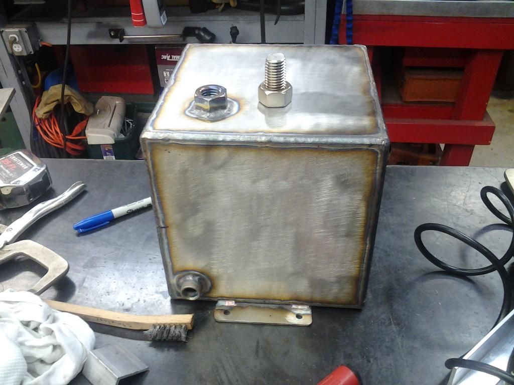

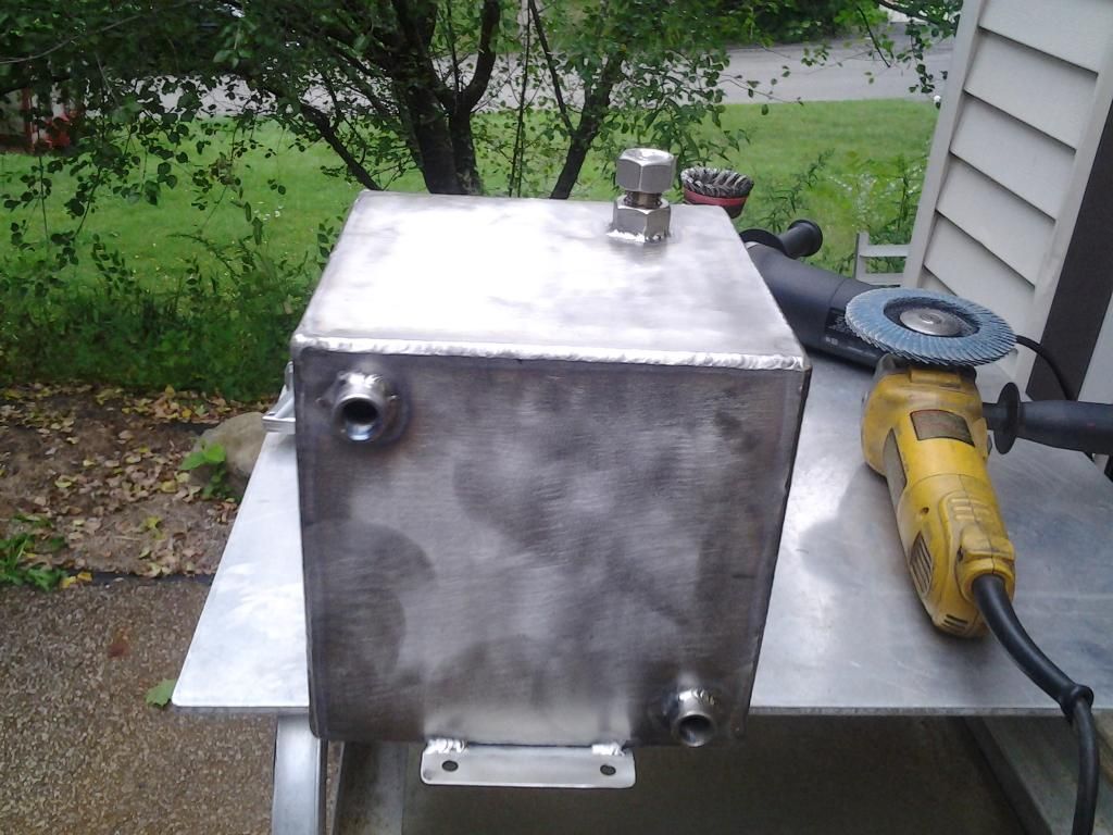

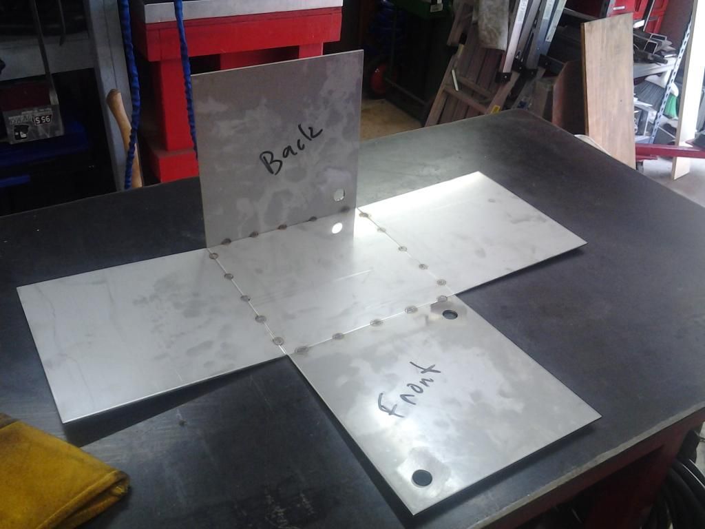

Reply:Here's where I am at. I sheared up 12 pieces 11 ga. stainless I got for free. I am got more than I needed just because it was free. I am making a tank that is 8" X 8".........this will give me approx. 2 gallon of coolant. I am wondering what and where to get the bungs and the filler cap. An idea on the cheap would be to weld a stainless nut big enough to tank a funnel and use a bolt as a filler cap. As far as the hose bungs go I was thinking again of welding nuts...........drilling out a bolt on my lathe........( basically a hollow all thread rod) and jam nutting it with about an inch sticking out to connect a hose to.Again any comments are appreciated.http://www.google.com/#q=stainless+weld+bungsGravelThe difference between theory and practice is that in theory there is no difference.
Reply:I found my some stainless bungs on Amazon, but I have some local places (hardware stores, but not big box) that have them too.Regards,RobGreat Basin WeldingInstagramBlue weldersRed weldersMy luscious Table

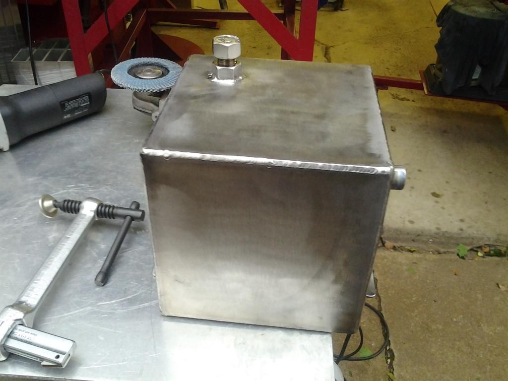

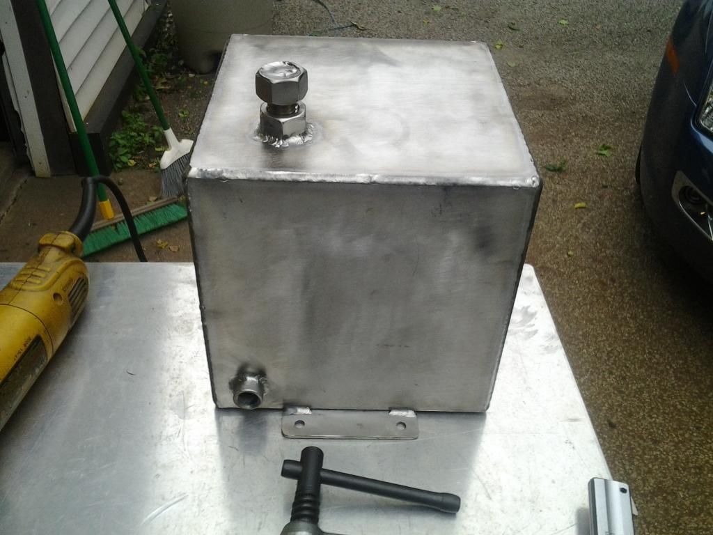

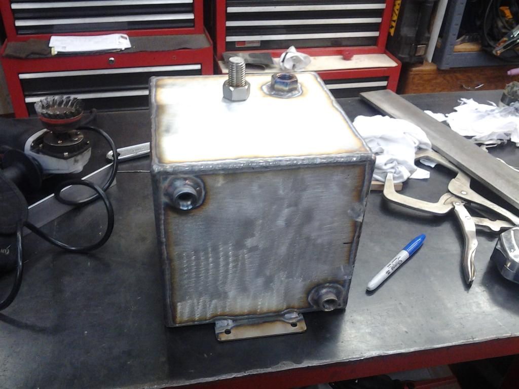

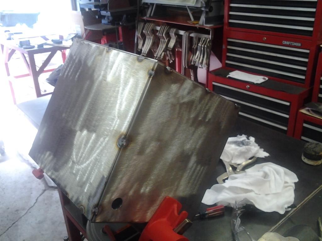

Reply:Got the tank built today. Went 8" X 8" 11 ga. stainless. Worked out OK. I started walking the cup using 4043 1/16" filler rod..........switched to freehand.........ended up just freehand and fusing the corners. Using open corners this worked out well. The first pic shows all sides (except for the top) tacked on the inside this allowed me to fold up all the sides making things pretty accurate.The 3/8" bungs are actually a cast stainless pipe coupling cut in half.......worked out real cheap. The cap is a 3/4" nut and bolt. I am leak testing it overnight.
Reply:It's the non-ferrous stainless filler rod. You've never heard of it? OP, sweet projectTeach Ag Mech - Mike At Home:Lincoln Electric AC225Miller Challenger 172Gas AxeWork:eclectic bunch of 90's vintage blue boxes

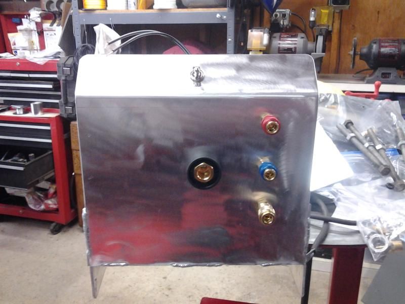

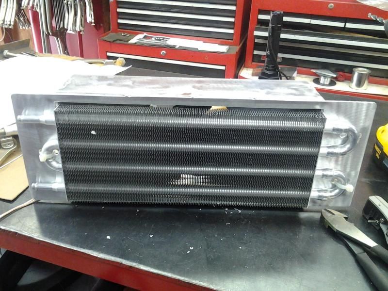

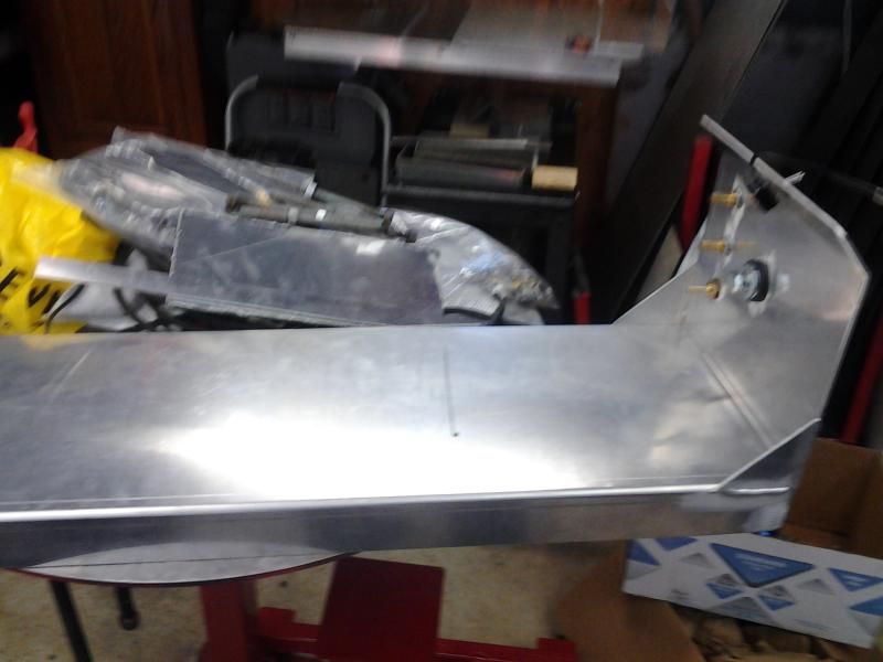

Reply:This is where I am at now. I have the the shroud mount built and the base as well as the tank. All I need now is the pump and motor.I am mounting this on a separate cart......this is the reason for the dinse and gas line connection on the front of the panel.I guess my aluminum welding is getting there.

Reply:You might want to move that fan out to were the blades are even with the shroud. The blade location were its at now; will make noise and chop air but not really move a lot of air. You could remake the bracket and flip the fan over so that the blades are level with the shroud since the direction of air flow make no difference.
