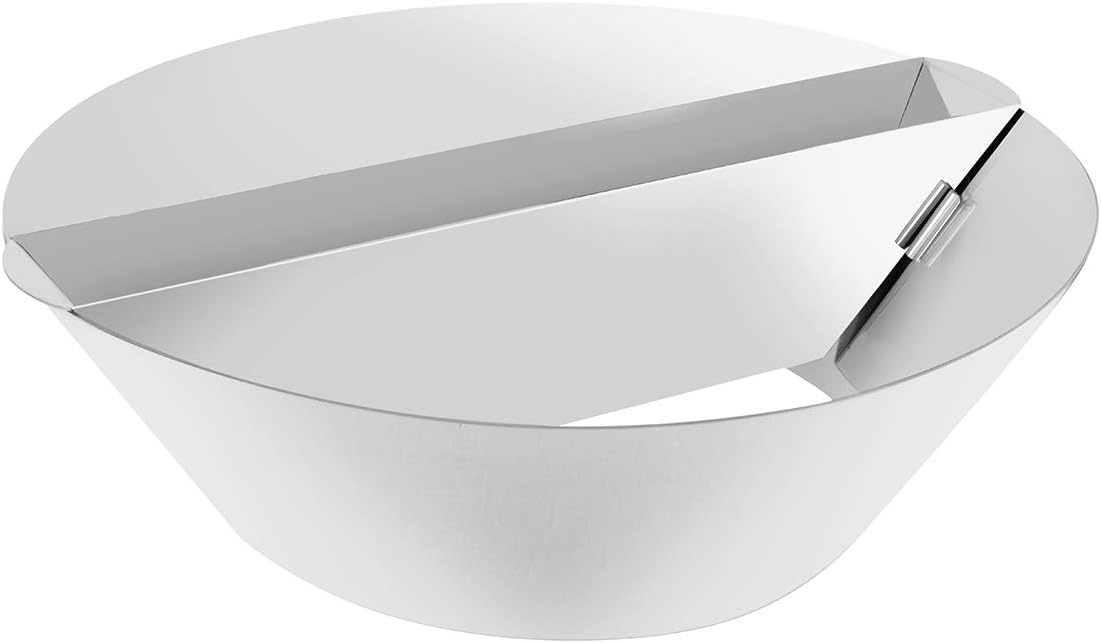

Reply:Ok - so without giving away what my specific idea is, I can say that the general concept is something similar to this product, which is already being sold. I'm not trying to copy their design - mine is similar in that it's also a BBQ accessory, but with a different design and purpose. Imagine this product but in a different shape to start. I don't really know anything about sheet metal, but it looks like something that should be able to be built with minimal tools? I think my design is slightly more complex than this one but not much. This certainly seems like something I could produce with cardboard or thick paper as a first pass prototype, but I would quickly need a metal version of it in order to be able to test it. Does this info help?

Reply:Is this product coming in contact with food? Are there regulations involved that would change your selection of materials?... eg, it may have to be stainless steel. Making something for your own use can be a different story from making an item to sell into the market...The harder you fall, the higher you bounce...250 amp Miller DialArc AC/DC StickF-225 amp Forney AC Stick230 amp Sears AC StickLincoln 180C MIGVictor Medalist 350 O/ACut 50 PlasmaLes

Reply:To the OP, if you go to an HVAC company, make sure you tell them it can't be out of galvanized metal. If that gets too hot or is contact with charcoal, it may off gas or melt the Zinc and other coatings. From a safety perspective,  your final item may need to be out of stainless steel or something that won't off gas. Stainless may warp when it gets too hot so beware of that as well. If possible,  put the prototype in place, heat it, then check the temp. That will help choose the material.  Check the example you posted and determine what that is made from. Or check items used the same way as your new product Sent from my SM-G996U using TapatalkLast edited by psacustomcreations; 4 Weeks Ago at 06:18 AM.Millermatic 252 MIGMiller Dynasty 200DX TIGMiller Spectrum 625 PlasmaAltas 12x36 Metal LatheBridgeport Milling Machinewww.psacustomcreations.com

Reply:stainless steel will last longer, and be nicer to deal with, but plain steel will do the job just fine, especially for a prototype. You'll need to find a sheet metal workshop, as above, HVAC companies have good sheetmetal guys but depending on area, shop etc, they might not want to bother with one-offs.That sort of thing could easily be whipped up in half a day by a sheetmetal fabricator. I see the example you gave is made from stainless steel, that might give you an indication of which material would be best...Murphy's Golden Rule: Whoever has the gold, makes the rules.
