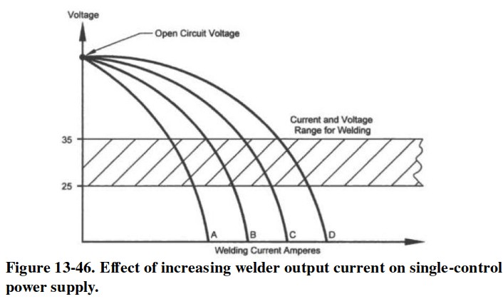

Reply:Judging from the Volt-Amp curves Oldendum posted, I would use the High range (the "B" curve that's closer to horizontal) for 6011 (to give more dig) and the Low range (the "A" curve closer to vertical) for 7018, because the "A" V-A curve should be more forgiving of changes in arc length. If you look at the two curves, you can see that as you change arc length (and thus arc voltage -- the vertical scale), the "A" (low range) curve changes the amperage less than the "B" curve. What that should mean when you use the welder is that on the "B" (high range) curve, as you decrease the arc length (and arc voltage), the amperage will increase more than it would on the "A" curve, giving you more dig. By the same token, changing the arc length when using the "A" tap will change the amperage less than when on the 'B" tap, meaning your amperage should stay more constant with changes in arc length, giving less dig (and less chance of blow-through) than when on the "B" tap.The OCV on the "B" or "High Range" curve should be lower than on the "A" curve (looks like it should be about 55V on B versus 75V on A), meaning it'll be more prone to sticking on startup, but that's just the way the mop flops...my engine drive welder behaves the same way.This might help:
As you can see, decreasing the arc-voltage from 35V to 25V (by shortening arc length) increases the amperage by a far larger percentage on curve "D" than it does on curve "A"  because the curve is closer to horizontal on "D" than on "A" (or mathematically, you would say the curve has "less slope" on "D" than on "A")... same deal with the V-A curves Oldencum posted...

Why? There are two taps on the transformer secondary therefore there must be two voltage settings.Well, yes but1. The different OC voltages give different options for usable electrodes.2. The loaded voltage is also different but variable as it is a constant current supply - so not stated.True but the welder is unlikely to be injured with either voltage because they are usually quite low.As I noted in my earlier post, in my view the taps are just a kludge to make some obstinate electrodes fire.Jack
Reply:Just look at the V-A curves. It's self-explanatory.
