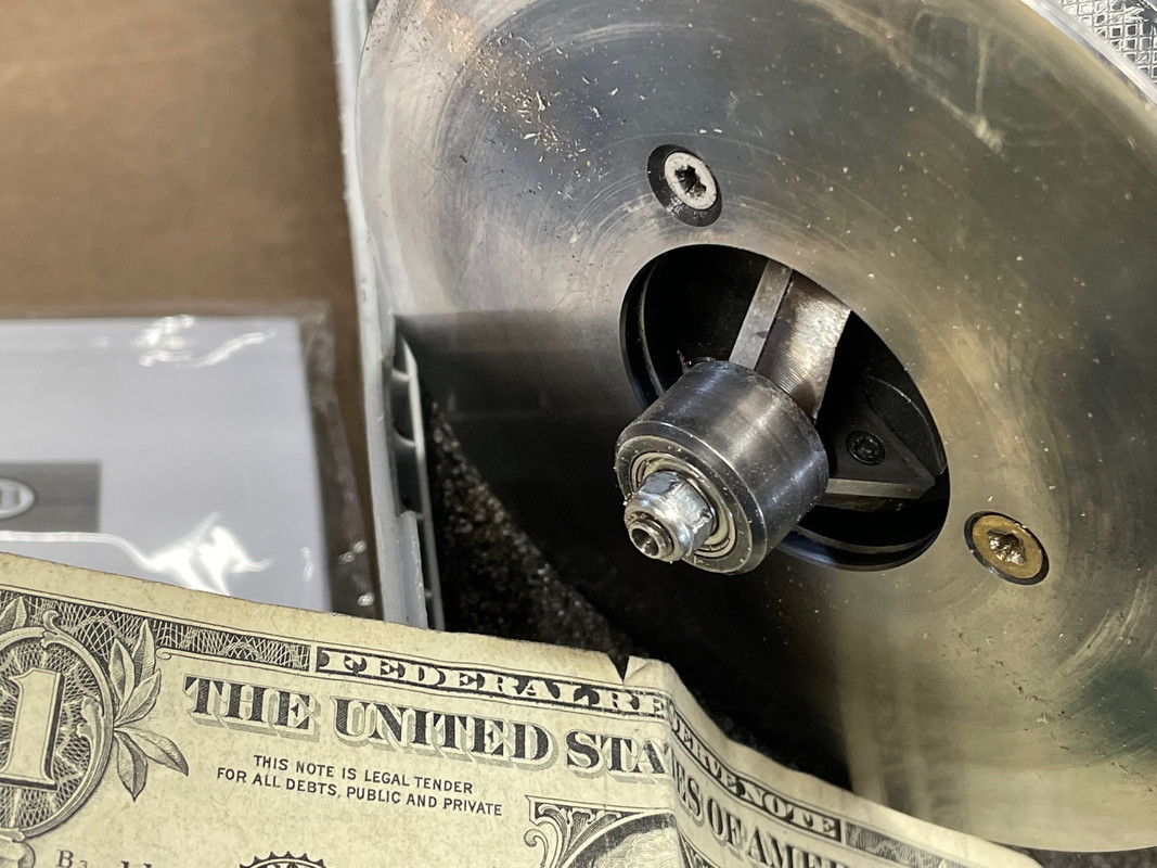

Reply:German-made BDS heavy duty plate chamfering machine I bought a few weeks ago (not inexpensive). Takes separate carbide inserts (shown in package.
Reply:That BDS is ten times the price and I am sure it is worth it. I dont mind spending good money on tools I know I will use. I bought the Ellis 1800 for that reason. If it turns out I use the beveler more than I thought, I may step up to something more respectable Sent from my SM-G930V using TapatalkMillermatic 252 MIGMiller Dynasty 200DX TIGMiller Spectrum 625 PlasmaAltas 12x36 Metal LatheBridgeport Milling Machinewww.psacustomcreations.com
