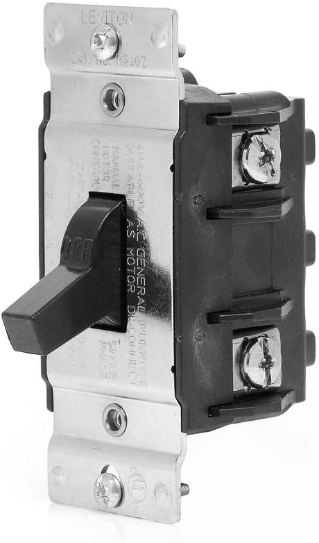

Reply:The power switch for a welder like this usually disconnects BOTH of the 220 volt wires coming in.So, if there is a cord, 2 wires from the cord go to the switch, 2 go to the transformer, then there is at least one wire for ground,,So, that would account for at least 5 wires,,The switch on my Miller welder died,, this is what I ordered to replace my switch,,https://www.amazon.com/gp/product/B0...?ie=UTF8&psc=1

Reply:You may have to "judgement call" figure where the wires go by the length of the wires,,Where can the wire reach to?
In this pic, the upper wires go to the machine, the lower wires go to the power cord,,in my machine, the power cord ground is bolted to the chassis somewhere.
I took this pic because ,, even though the terminals were numbered the same, the new switch was wired differently.The old switch conducted up and down,, the new switch conducted side to side,,that was a surprise!!
