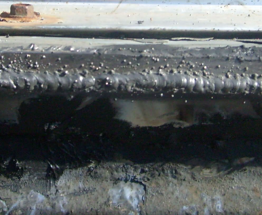

This thread is about making MIG look TIG,  or really nice looking mig welds. I am going to try something.  ONLY POST IF YOU HAVE A PICTURE OF YOUR OWN WORK.  The point is we want to SEE your attempt.I am going to try to master this too.Here is my picture.  It aint like ZTfabs, but it was about 200 feet of weld.WFS 330 of .035, about 20 volts C/25. This is 3/16" square tubing so there is a natural perfect fit up. I should have been at around 200 amps.
Horizontal, making circles going up on the forward stroke.  First pass on clean bare steal, second pass down through the puddle.  I turn the heat WAY UP to do this.   200 amps on 3/16" horizontal groove.Here is a link to another threadhttp://weldingweb.com/vbb/showthread.php...hlight=mig+tigNothing discussed here but Mig welds.David
edit:  Mig gun was held straight in the joint.

Reply:I was welding bucket teeth on using a forward whip and bare wire.

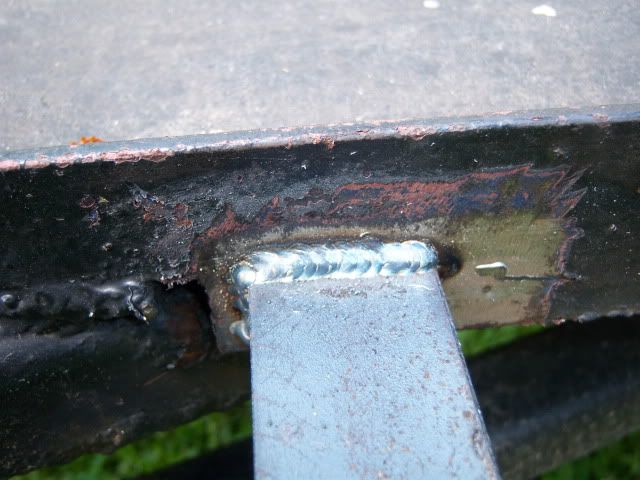

Reply:Here was my attempt on 3/8 plate to 5/8 roundbar. I used a lincoln weld pak and .035 lincoln innershield nr211mp wire. This was a table mount for my sander.Shane

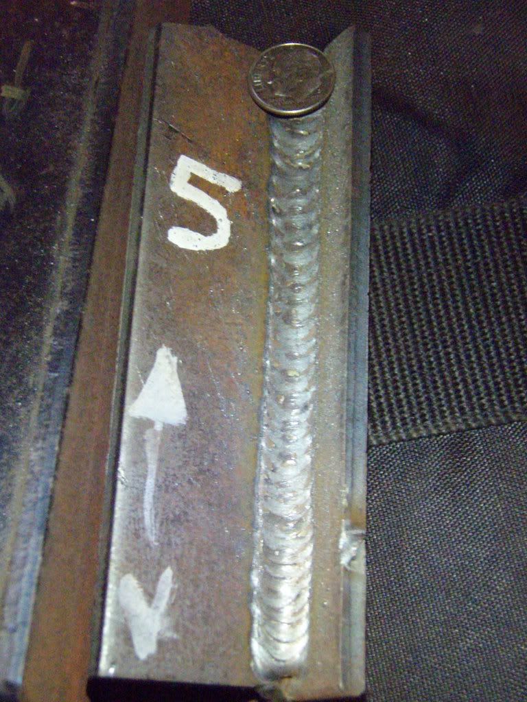

Reply:My first attempts were more like "MIG like MIG".I cut 8 coupons of 1/8" CRS and tacked them to give myself open groove joints.This was also my first try at pulling the torch, I usually push.Each coupon was welded in 2 steps, from the corner to the center tack, left to right, with changes in WFS and voltage made on each half. You can see the reference marks: 1A/1B,2A/2B, etc.Basic settings: Lincoln PM300 in GMAW (#5) mode....no pulse..035" ER70-692/8 Ar/Co2Coupons tacked but needing cleaned. The "Spot" feature is cool! .5sec duration.
Coupon 1: A side,  150 WFS / 20 volts Too Hot!!....B side,  150 WFS / 17.5 volts.
Coupon 2: A side,  140 WFS / 17.5 volts....B side,  140 WFS / 16 volts....still hot.
Coupon 3: A side,  130 WFS / 16 volts....B side,  130 WFS / 15 volts....unstable arc @ 15volts, 16 seems mo' better.
Coupon 4: A side,  120 WFS / 16 volts....B side,  110 WFS / 16 volts.
Coupon 4A seems to be the best of the lot, from a WFS/Volts standpoint. I think my technique of making the "e" is too slow. Like, I'm not taking the horizontal move far enough to the right before I curve back around counter clockwise.I spent about 1/2 an hour doing "dry runs" with the machine turned off so as to get a feel for the drag/"e" technique. The 400 amp gun is definitely NOT the one for this!Comments and pointers will be appreciated!Rex

Reply:Amps or heat is the wire speed.Volts are the bead width.  You can see that in  your cupons.I would try 120 to 130 ipm with about 17 -18 volts.  To your own taste of course.....If you look at cupon 3, A side you are close, but there is too much weld or wire.you could also try straight in and push.I like the attempts, looks like you are on your way!More  pleaseDavid

Reply:Thanks Reebs.Here's a pic of a scrap piece of tubing that I welded to some .125" plate. The tube is 1.75"x.120" DOM mild steel.I used my Lincoln PowerMIG with .030" ER70S-6, C25 gas @ 15cfh.

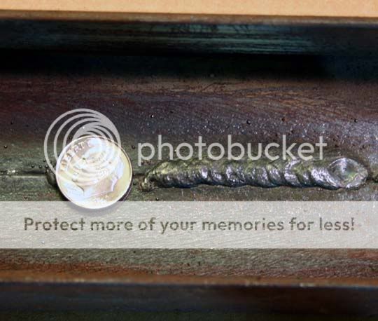

Reply:Since David asked for pictures, I took one and decided to join the conversation.
I spent all day today with short-arc mig.  Took three pics with my cell phone while on my lunch break, one of those pics didn't end up blurry.  When I'm laying down a bead I'm not trying to achieve a psudo-tig appearance.  I am oscillating the puddle for two reasons;  first is to ensure that both toes are tied in by getting the arc out on each leg.  Second is because I find it very difficult to make a weld with consistent size and profile if I'm not oscillating, counting each oscillation to maintain a rhythm.  The oscillation pattern I used for the weld in the picture was ovals, or oval like loops.  Joint is a flare bevel, welded with a drag angle.  Elsewhere on the part are welds I made downhill in the same joint configuration have a different appearance (flatter and smoother), as position dictated a different technique.
